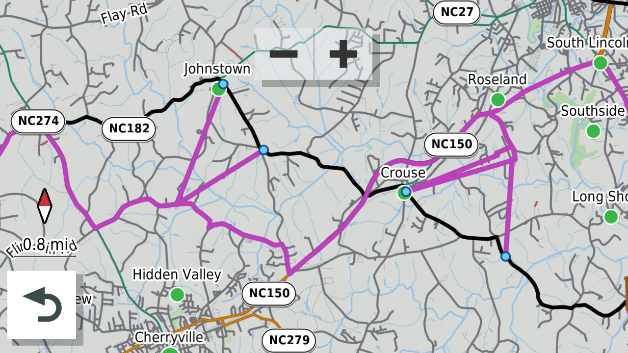

Peobody,
I see two perhaps separate issues, one of which I think is exactly what you describe.
First is the bogus closure symbol. That may not be due to complexity, though I suppose one of the lower-level roads in that mess might be closed, though I have no evidence of same. Second is the nonsensical recalc route, and I am sure the complexity coupled with some possible position error could be a big factor.
Finally, what the heck is that black line beyond the closure symbol all about?
Posts: 2124
Been liked: 560 times
Re: My first encounter with phantom road closures
danham wrote: Thu Nov 14, 2024 6:41 pm First is the bogus closure symbol. That may not be due to complexity, though I suppose one of the lower-level roads in that mess might be closed, though I have no evidence of same. Second is the nonsensical recalc route, and I am sure the complexity coupled with some possible position error could be a big factor.
The last road closure recalc I experienced produced in a route that was not rideable. The black line is the track of the original route. Travel direction was eastward. The closure was at the bridge over the stream that is visible to the east of the "NC182" marker.
danham wrote: Thu Nov 14, 2024 6:41 pm Finally, what the heck is that black line beyond the closure symbol all about?
Did you have a track of the route showing on the map in black? If not, I don't know.
Post by danham »
Nope, no tracks displayed. I once saw similar bogus closure on I-84 in CT, and it also showed a black line beyond the closure. But unlike my Boston fiasco, ignoring the closure did not affect the route or cause a recalc request.

I have also been able to ride through some closures, but then others force a recalc. I wonder if there are different classifications of closures. Maybe a closure for repaving will not force a recalc but a closure at a bridge will (traversable vs. not traversable). That feels like a stretch but it would explain why sometimes the XT acts one way and sometimes it acts another. This makes me think of "road closed" signs on the shoulder when the road is open but there is work going on off the road surface. I'm convinced those signs are there solely to alleviate the contractor of liability. I don't know whether those 'closures' would be submitted to the traffic provider of the Drive app.

We dont have many multilevel highways in the UK. But the exit and entry slip roads run pretty close. If the route is along the motorway, and I take the slip road. It doesn't indicate that I am on the 'wrong' road until I start heading in the wrong direction. If it loses the signal it assumes I am travelling at my last known speed along the plotted route.
I spotted that black line once before - I thought it was a track that I had installed at the time. But it could well have been a 'remnant' of the original route, now you mention it. Does that mean it leaves a trace of the original route for you to follow ??

jfheath wrote: Thu Nov 14, 2024 10:51 pm Does that mean it leaves a trace of the original route for you to follow ??
That is an interesting question. That black line is thin and appears to be bordered by a faded magenta. I wonder if anyone who shows a track on the map in black would see it. I normally do, and I have never seen it.

Peobody wrote: Fri Nov 15, 2024 12:47 am
The magenta is, as I’m sure you know, the original route. The black appears to be layered on top as part of the warning that the road is closed, which of course isn’t.
