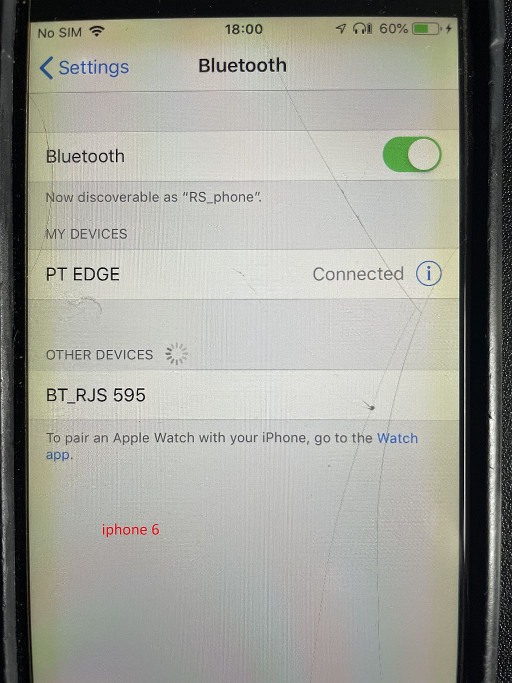

Pictures. Hopefully legible
Those named "iphone 6 . . " show the unsuccessful attempt to connect the cardo to an iphone 6 with v5.9 of Cardo Connect
Those named "iphone 14 . .. " show the successful attempt to connect the cardo to an iphone 14 with v7.6 of Cardo Connect
"Zumo" shows that my devices are paired thus: "RS_phone" <-> Zumo <-> Cardo Edge
Hopefully, this will ensure that the Edge does not attempt to control the phone which feeds the data from Garmin Smart Link and phone calls to the Zumo . . . ("RS_Phone)
It's unfortunate that I cannot establish a connection between the iphone 6 and the Edge because the iphone 14 belongs to my employer. Can anyone suggest why the 6 is not useable? PS. I find it odd that the Edge appears to be connected as audio source to the iphone 6 - evidence being the microphone.
