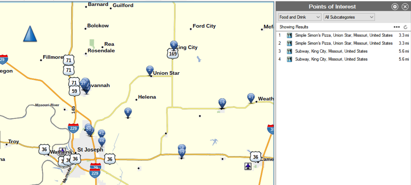

I don't think this is a map issue. It been a problem for me through many different versions of maps. It is very common for me to see a large number of blue balloons on the map but only a few listed in the POI pane (image below). Sometimes, changing the map zoom level helps, sometimes not. Sometimes, refreshing the list will display more. Sometimes multiple refreshes are required. I will attempt refreshes both with the "Refresh Find Results" button and the "Find More Items" button. I never know which one will work, or if neither will work.paynes1 wrote: Mon Mar 25, 2024 10:40 am only about half of the points of interest are showing in the 'Find Options' drop down. FORTUNATELY, 2024.2 stayed on my PC and wasn't replaced and this works perfectly.
Re: CN NA 2025.10
This is a reply. It's not an answer, because I couldn't say that I know the correct answer. But I can fiddle and get the results that I want. I use the search POI feature very rarely - because the data has proved to be unreliable on the one occasion in Spain when I relied on it entirely for hotel addresses.
But I can share the results of my fiddling. As long as you take what I say here with a pinch of salt - something to flavour your own research - rather than an actual fact.
That minimum list is a common feature. Garmin like to get a quick result rather than expect you to wait for it to search its entire database. Generally speaking it stops after 4 or 5 results. Initially.
It searches around a particular area - the centre of the displayed map.
There are a few things that you can mess around with - I was going to get some screen shots, but decided it was probably quicker to record a very amateurish video.
Show it full screen it's full screen resolution 1280x720 so that you can see the detail. It sometimes takes a few seconds for Youtube to get the high resolution detail, but then it suddenly jumps into sharp focus. If it doesn't then choose the option at the bottom of the video to show it in YouTube.
[edit] - Something that I didn't put in the video. If you move the map about, new POIs do not automatically show up on the map. You have to click the refresh button for that to happen - it then searches again using the new centre of the map as the location to search.

That video demonstrates the frustrating yet normal behaviour of the number of found items indicated on the map not matching the list of items, requiring some fussing about. As an FYI, Ctrl+Alt+F will open the Find Options window. This saves you some clicks as compared to using the Search function, especially when you are searching for a specific category of POI like lodging, food, or fuel. I agree with @jfheath about this database being inaccurate, but I find it to be a valuable resource, followed up with verification to confirm whether a location of interest actually exists, is still in business, and is located where Basecamp says it is (Google Maps is my primary verifying source). It is not uncommon for me to add one of the search results as a waypoint and then replace its coordinates with ones from Google Maps because of how badly misplaced it was.
