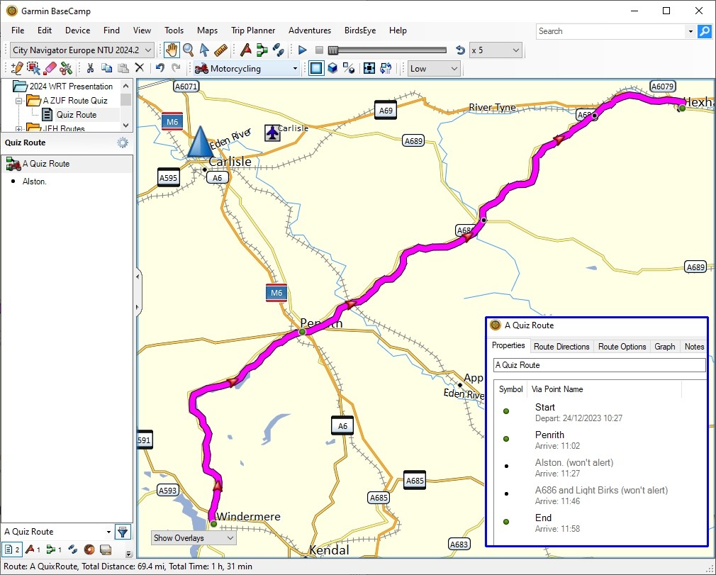

A Question to illustrate the above.
Below is a screen shot of a simple route that I have prepared.
The information to answer the questions is in the image and in the text above.
Right click the image and select "Open in a new window" to get a larger, clearer view that you can move to one side.
How many route points ?
How many Via Points ?
How many Shaping points ?
How many Waypoints ?
How many would appear in XT's Favourites ?
A Quiz Route.jpg (163.73 KiB) Viewed 3231 times
You don't have to answer, but feel free if you want to - or drop me a PM. I'll reply by PM
I'll post the answer later.

As for the quiz...
If talking about the number of Points as listed in the route summary, no way to know.
If talking about the sum of Via and Shaping points then 5
3 including Start and End
2
0
0

The answer to the quiz:
Vias 3 (Penrith, Start and End)
Shaping Points 2 (Alston. and A686...)
Waypoints 1 (Alston.)
Favourites 1 (Alston.)
