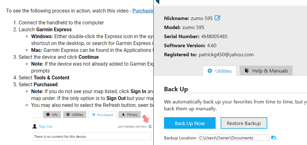

This is a snip clip, on the left, the WEB TUTORIAL. My Express on the right, I dont have the tabs shown.....

Re: new PC
Ok, maybe I misunderstood. Are the maps ones that came originally on your device or did you add them later? If so how and what maps were they? The instructions you posted above refers to handhelds.
If they came with the device from new they won't appear in purchased maps.
What version of Express are you running? If an old version the first thing to do is update it.

I am running Basecamp version 7.4.1.0 on a Win 7 PC.
I open Garmin Express and click on my GPS, Zumo 590 and I get:
Then I click on "View Details" and get:
Then I click on "Installation Options" and get the options to pick where to store the maps.

Re: new PC
Well that's your issue as that is well out of date. Update Express and you should see Map Options.
