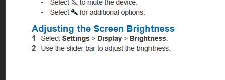

Screen issue is probably connected to the power issue, as all Garmins unless they've been set to be the same have different brightness settings depending on whether running off external power or battery.

Just try it and you'll see. Maybe the XT doesn't but all other Garmins I've used do. See here
