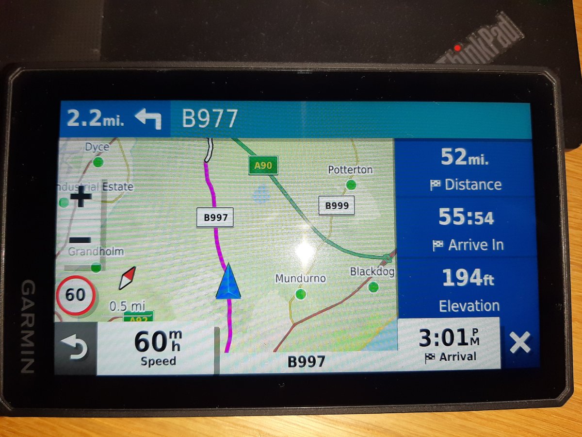

Real screen shot, using the Map Toolssussamb wrote: Wed May 27, 2020 12:04 pm No, Map tools if you've ticked the Trip Data box then allows you 4, from the map screen tap icon bottom right and selected Trip Data
- 20200527_140546[1].jpg (197.77 KiB) Viewed 4513 times
