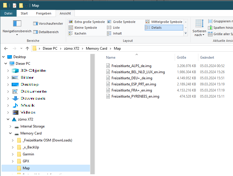

Re: How to install OSM Maps in XT2
Post by proofresistant »
Is the SD formatted with FAT32?
I would check that first.
I myself only need European maps and use those maps from ‘Freizeitkarte’ , like https://www.freizeitkarte-osm.de/garmin ... uropa.html
I down load the file end extract the zip, copy this *.img to the SD in the ‘Map’ folder.
This works for me.
May you get a small map for testing, e.g. https://download.freizeitkarte-osm.de/g ... pp.img.zip
and try it out.
When I then connect my XT2 to the PC, it looks like this.
It is strange when Basecamp recognises the XT2 but the XT2 itself does not.
