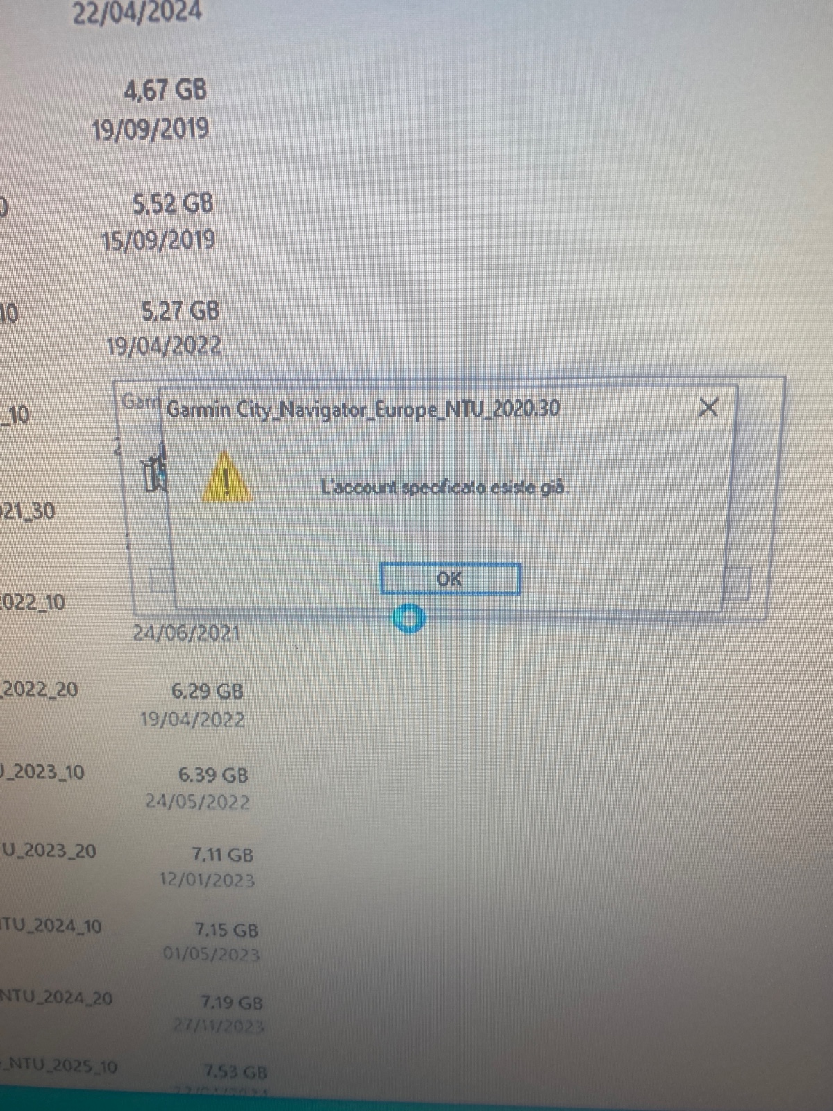

Cannot uninstall. This is the warning.
Allert
Allert
Re: No Maps on the Basecamp - Urgent help
You have a corrupted Windows uninstaller. If you search on Google you'll find ways to repair it. Once you've repaired it you should be able to uninstall the maps and then use Express to reinstall them.

The problem is only for that. I uninstalled the other versions. Now I have only the latest ntu version, 2025.10.I can't find the NT.
I'd still repair your uninstaller. You could also try JaVaWa's GMTK to remove the maps
