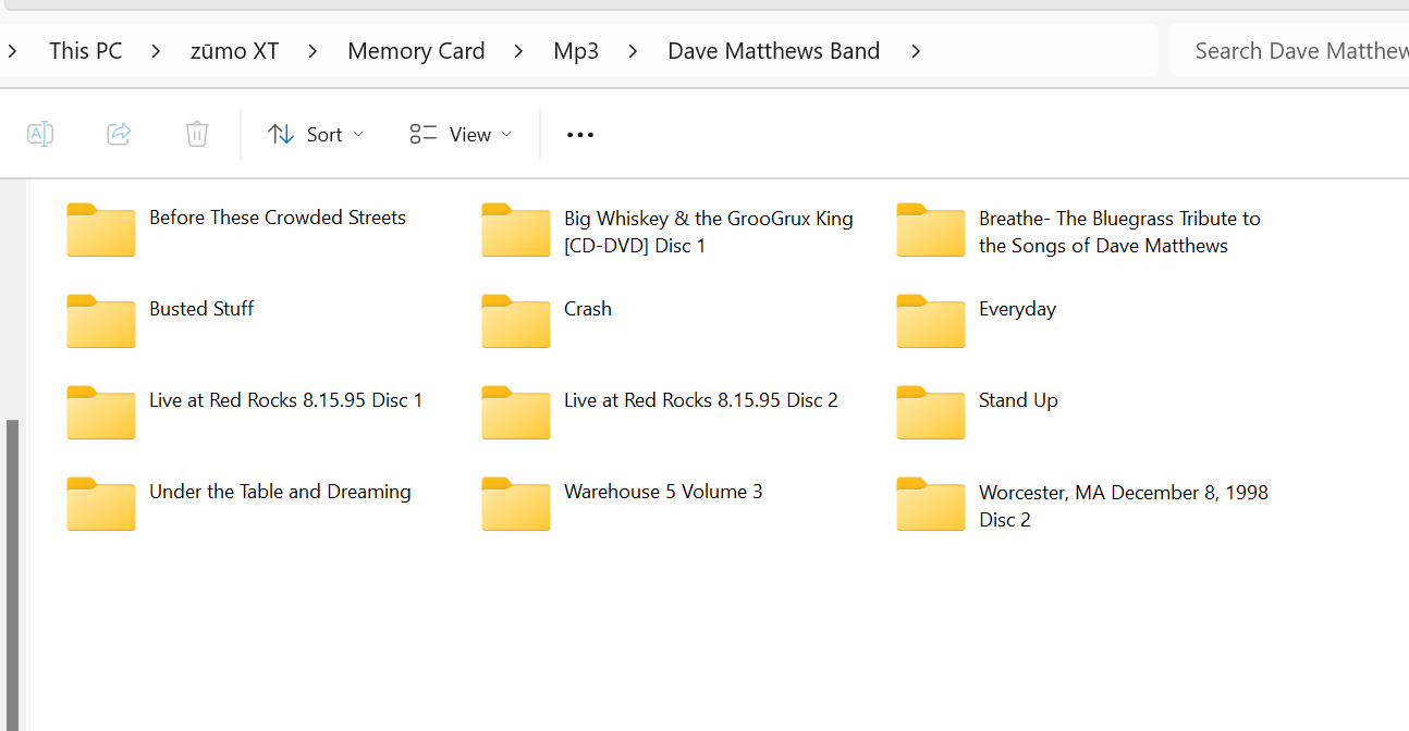

Has nothing to do with Garmin and everything to do with file management. Can't help with a Mac but I use the File Explorer on my Win machine to see the SD Card as a drive called Memory Card. I do this without removing the card from the XT but I understand from Mac users it may be better to place the card directly into the computer. I created Mp3 folder the on memory card and then I created a folder per artist or band inside the Mp3 folder. Then I copy the albums for that artist/band to the appropriate folder so the file structure looks just like it does on my computer. zumo XT/Memory Card/Mp3/Artist or Band Name/Album Name/Songs.
In this pic you can see the path string at the top with all the Dave Matthews Band albums in the Dave Matthews Band folder. Each album has all of the songs on that album in its folder and ONLY the songs on that album are in that album folder. It's like that for each band/artist. When the XT plays the song, the artist displays as well.
