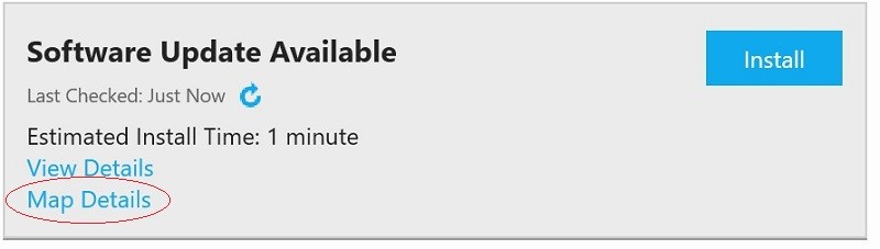

OK.. try this Chris, when your Zumo is connected to express and you click on the picture of your Zumo, do you get this 'option'?
- Udates.jpg (23.51 KiB) Viewed 2961 times

Hi chaps, only just got back from a day out.
Les, no I don't get Map Details come up. Probably because I don't have lifetime maps and I can no longer buy updates.
Sussamb, I have the original map disk which came with the sat nav and I have the unlock code. Plan was to see if I can install this on the PC. This map is the same as on the sat nav as I never updated it.
