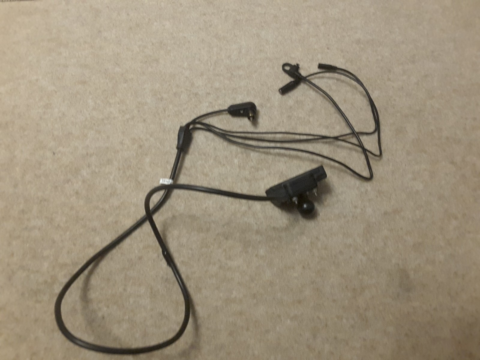

I bought my 550 many years ago (well it would be wouldn't It! :D ) for use on my Triumph Tiger 1050. I only used the Powerlet connector and the others for Audio Out, Mic In and an unknown one were taped together and the cables looped together and taped to shorten the overall length. This was Ok on the Tiger as there was a decent run between the sat nav and the power outlet and the bulky cable sat in the part fairing.
I've swopped the Tiger for a Triumph Scrambler 1200 XE and fitted the power outlet and mounted the sat nav and it works fine. The cable is far too long though and I want to lose all the connectors that I'm not using. I assume I can cut those off adjacent to the block? There is a thicker cable going into the block which I'm assuming contains all the cables bundled together? Ideally I'd like to do away with that block and reduce the cable length. Anyone know what the cable with the unknown termination is?

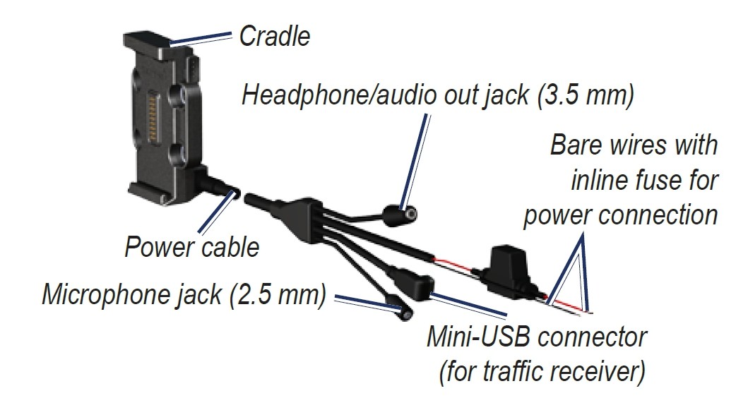

The 660 cable looks like this
Zumo660 Wiring.jpg (84.84 KiB) Viewed 4358 times
I wouldn't go trying to separate any of that little lot. You will regret it.

This article https://motorcycleinfo.co.uk/garmin-zum ... index2d35/ describes taking a pair of cutters to the cabe and shortening it. Assuming the 660 cradle is similar to the 590/595 there is a better way if you're comfortable with very fiddly wiring. It's described here:- https://jahonen.kapsi.fi/Electronics/Ga ... le_cradle/

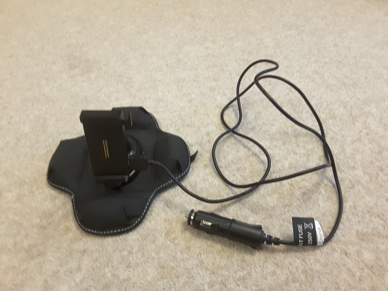

I did use the 660 in a couple of cars but didn't want to use the supplied suction mount so bought the bean bag type mount which sat on the dashboard and worked well.

Bear - thanks for the links to the cable modifications, just what I was looking for. I have heat shrink etc. and it wouldn't be a problem for me but still hesitant about attacking a perfect cable! Had a look on EBay for another cable and the prices are wow for what is now an old device!
The cable from the car mount would be ideal as it only carries power!

Here is my cable with the Powerlet fitted. Way too much cable and bulk for my naked bike! You should just be able to see the tape which marks all I need now!
