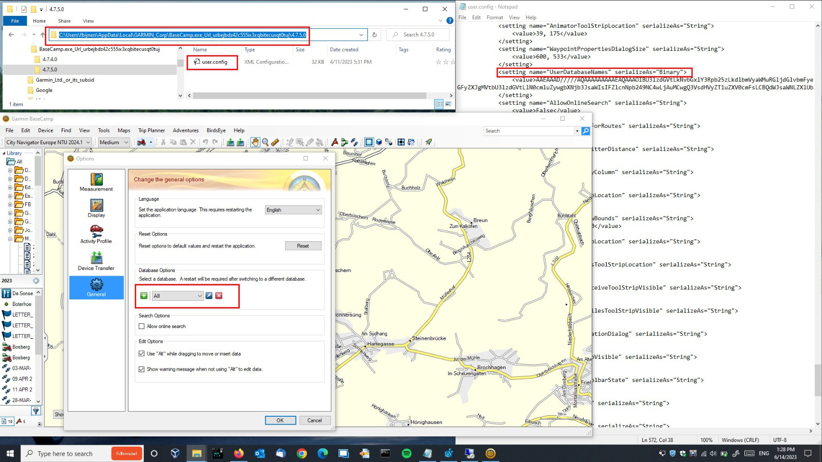

Re: Matching BaseCamp settings
@Bear @Rofor
The script is useful. But as I found out it does not save everything. An example is the setting 'User Databases'. I use several databases, you can edit the names and locations in 'Edit/Options/General'. These settings are not saved in the registry, but 'somewhere' in %APPDATA%, in an XML file called user.config. See the screenshot.
