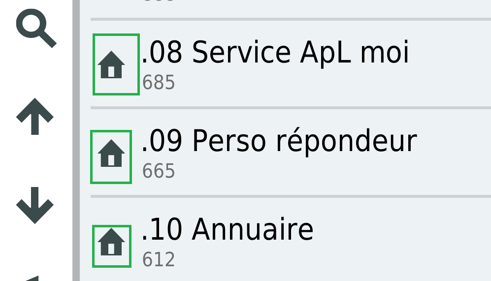

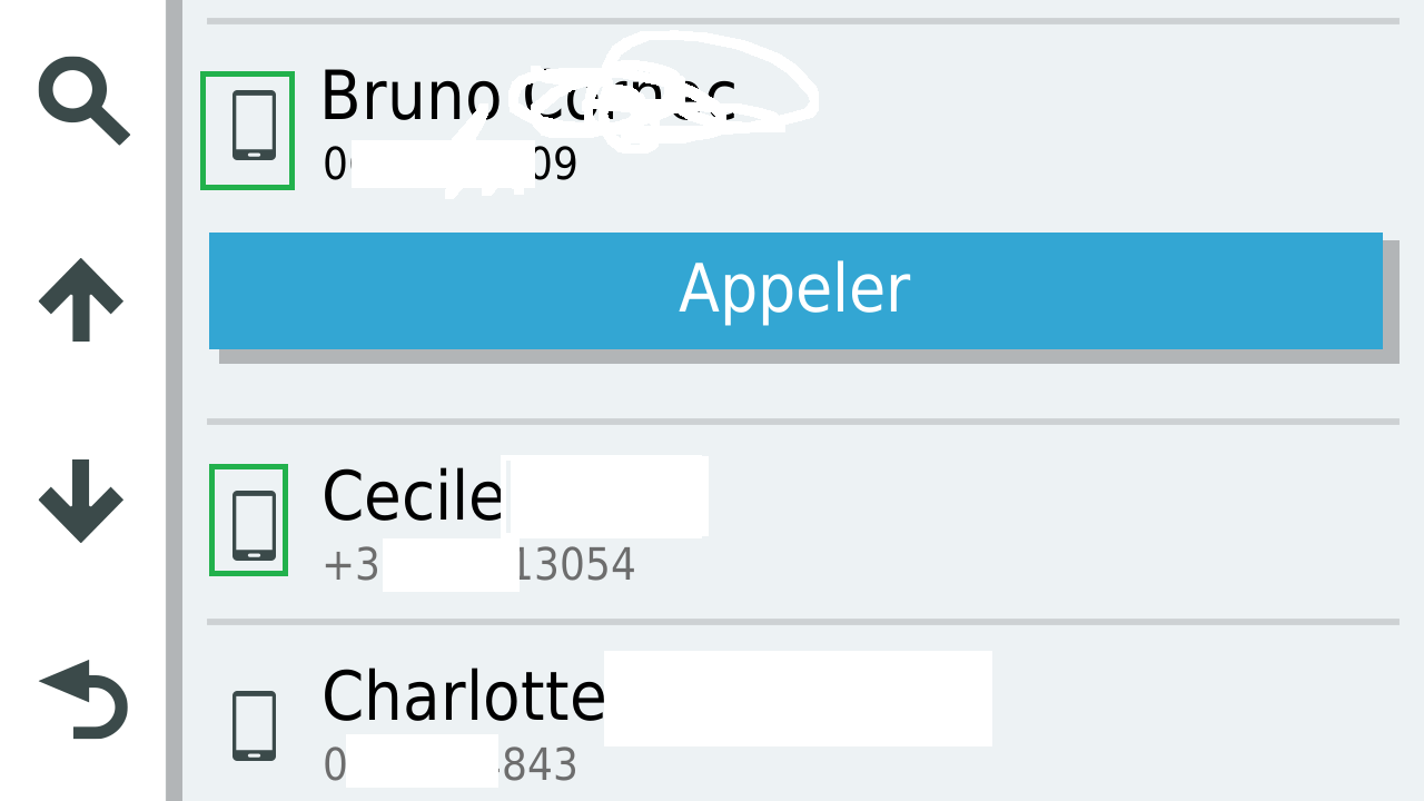

As you can see some entries in the XT' phone book are shown with an icon representing as phone. Some others come with a house/home. I am not sure whence the entries with a home/house are coming and how to delete them.

I was wrong, there was still a few entries on the SIM card, I did not delete all of them. apologize for the "noise"
ps1: The entries shown with a "house"or a "home" are the entries found on the SIM card, the other entries are those coming from the Contacts app (Google Contacts for me).
