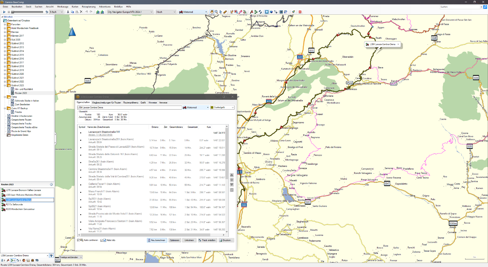

When you start to plan a route, the name is taken from the starting point to the finish point of the route - i normally double click the route in the left list and open the route information and there i change the routes name to what i like - but this also works, when i click on the name of the route in the left list and change it there!
The name of the list is displayed on the Zumo XT just as i named it - also the GPX file contains 'my' name in the XML code - just tried it a few minutes ago - here are two screenshots...
Basecamp with open route information window:

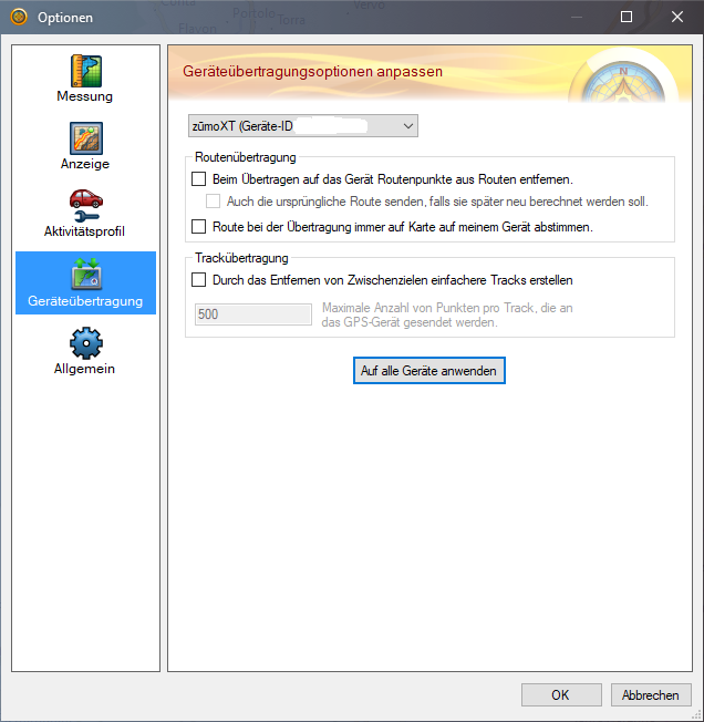

Did you, maybe, have in Basecamp any of the options in 'Device Transfer Options' in the settings ticked? They all should be unticked(!)...

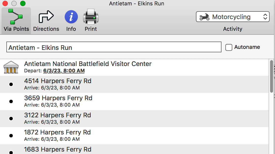

This may be a difference between Mac and Windows versions of BC? Here is Mac, with a check box for "Autoname."

@Rofor - I'll check the "Device Transfer Options" tonight.
@Danham - Mine is a Windows 10 computer and there is no box shown for auto naming as you show. Looks totally different.

I checked the "Device Transfer Options" and the only box checked was the 2nd one that related to forcing the exported route to use the map on the device. I unchecked this box and changed the name from the lower left pane, exported the route to both of my Zumos and the name I changed it to did appear on the device when I booted up the Zumo.
So, although I don't see how this checkbox (checked or unchecked) would have anything do to with the name of the route, it did work and appears to have solved the problem; However, I guess now I will just have to make sure that the maps I use on Basecamp are the same as the maps in the Zumos. I wonder what issues this will create if they are not the same.

The naming of this option is a bit misleading, as it don't check if the map used for planning and the map on the Zumo XT are the same - it signals the Zumo XT to ever do a recalculation of an imported route, even when the map on the Zumo XT and on Basecamp are the same!WilcoJunoHotel wrote: ↑Tue May 02, 2023 11:31 amSo, although I don't see how this checkbox (checked or unchecked) would have anything do to with the name of the route, it did work and appears to have solved the problem; However, I guess now I will just have to make sure that the maps I use on Basecamp are the same as the maps in the Zumos. I wonder what issues this will create if they are not the same.
