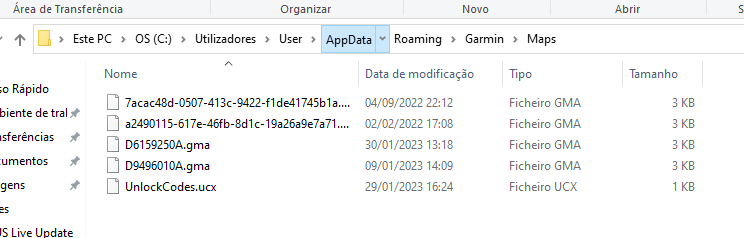

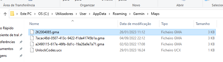

These were the codes on my PC before trying the map reinstall on Zumo XT:
This is the same folder after map reinstall on Zumo XT, removing the highlighted .gma file provided by Garmin Support, and copying the two .gma files from Zumo XT with the help of JaVaWa GMTX:
codes final.PNG (27.81 KiB) Viewed 5337 times
Hope this thread can help someone in the future with a similar problem

Anyways my mapset was already on the PC folder when using GMTK software:
The problem was map being locked and unusable.
Your problem seems different has you can't even download it to the PC.
Do you get a error message at the end on GE like I did? And have you checked Maps folder to see if the map is already there?
