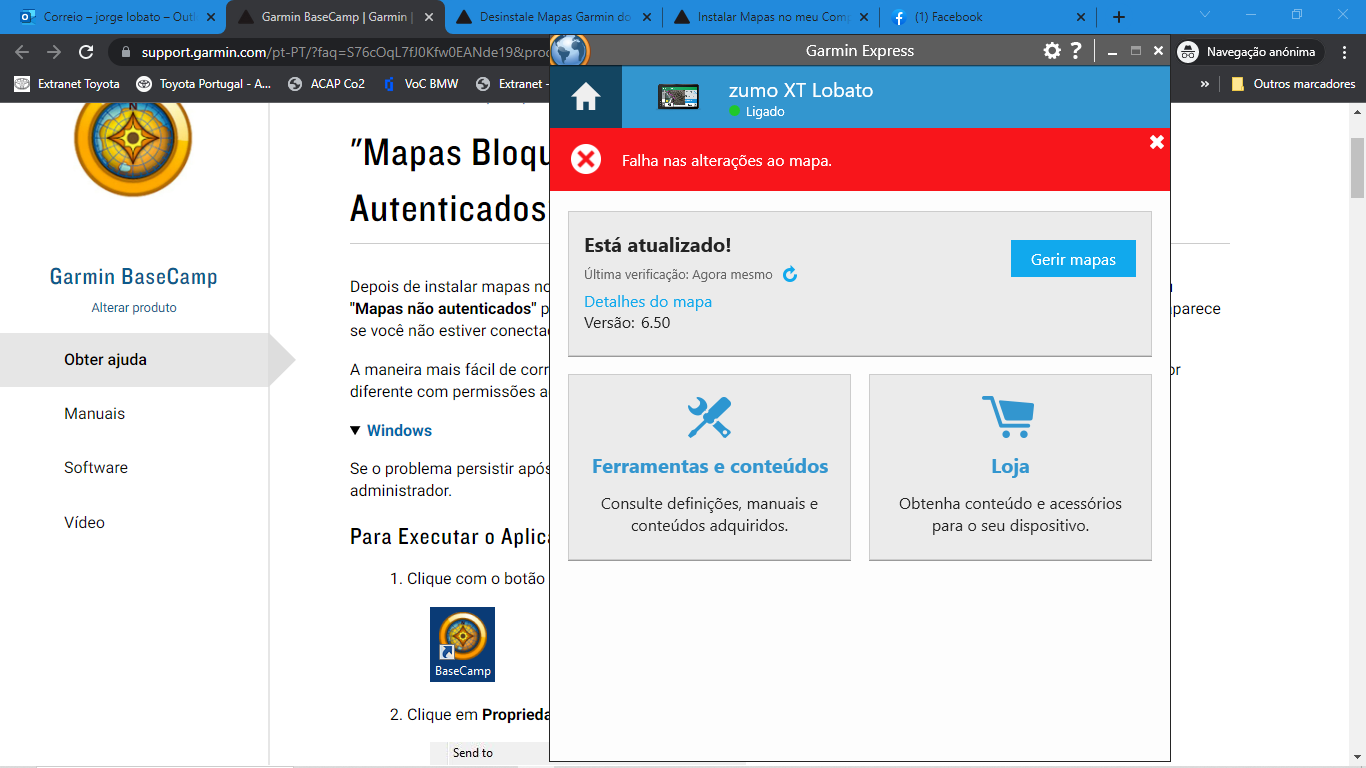

Two weeks ago I successfully updated my Zumo XT to map Europe 23.20 with Garmin Express. When installing the same map on the PC it showed a red message in the end "couldn't perform the changes to the map".
Red message "Fail to apply changes to the map"

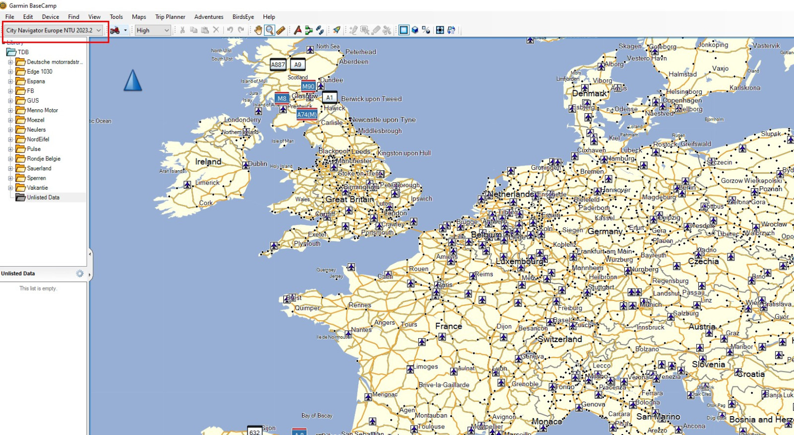

Opening Basecamp, the map was there but said it was locked.
Locked map message everytime I open Basecamp

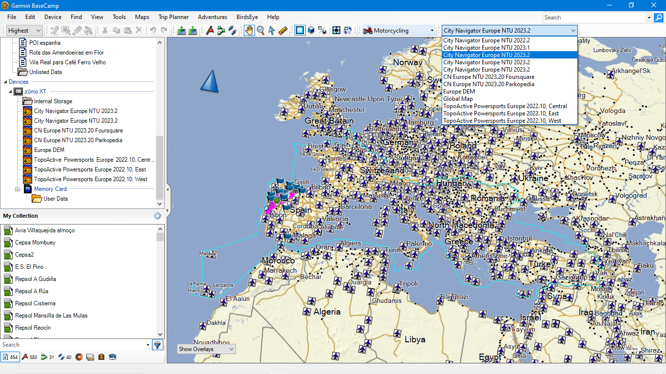

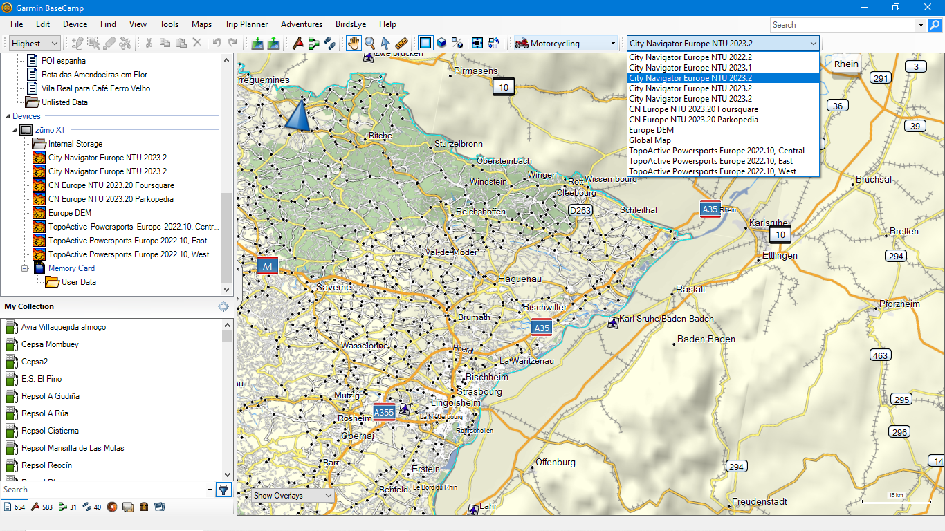

With Zumo XT connected it shows the map divided in two zones, North and South divided by a blue line. I guess this is normal because of file size limit on FAT32. Limit is 4 Gb so it's divided in two 4 Gb files (North and South)
Using 23.20 map from Zumo XT: a blue line surrounds the Europe North. Inside blue line the map is detailed, outside it lacks detail, only shows main roads, like the Global Map
Zoomed area of the same map in Zumo XT to show the different detail between South Europe and North Europe in French/German border
Selection of the other 23.20 map in Zumo XT shows a blue line around Southern Europe and the opposite happens regarding map detail to the Northern portion of the map
Selected 23.20 map installed on PC with no blue line around any Europe zone but message "Map detail locked" message on the bottom right corner.

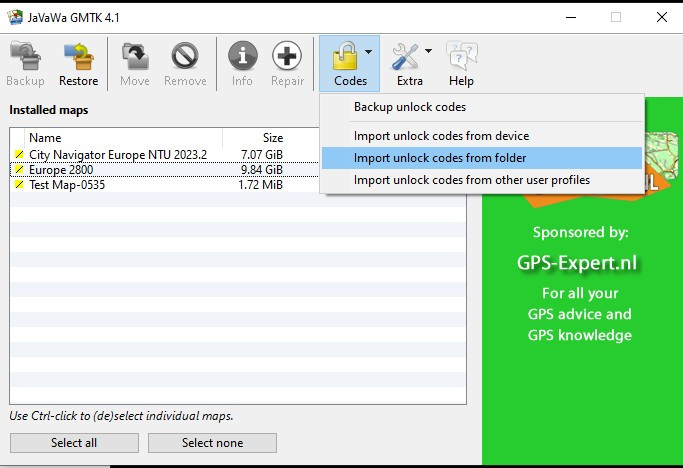

But to solve this issue you could also try JaVaWa GMTK. https://www.javawa.nl/gmtk_en.html
Step 1) find the GMA files on your ZUMO XT. On mine they are in 'This PC\zūmo XT\Internal Storage\.System\Map' (You will have to make the .System folder visible in the developer menu. More info: app.php/ZXT-P84)
Step 2) copy them to you hard drive
Step 3) Use JaVaWa GMTK to import the GMA files. (Import unlock codes from folder)
Note: JaVaWa GMTK cannot import directly from the XT because it uses MTP
Good Luck

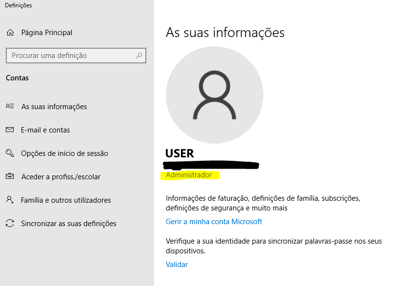

My PC only has this account "User" and it is already at Admin level:
Yellow highlight: Admin level of "User" account

For my own piece of mind I did the following test.

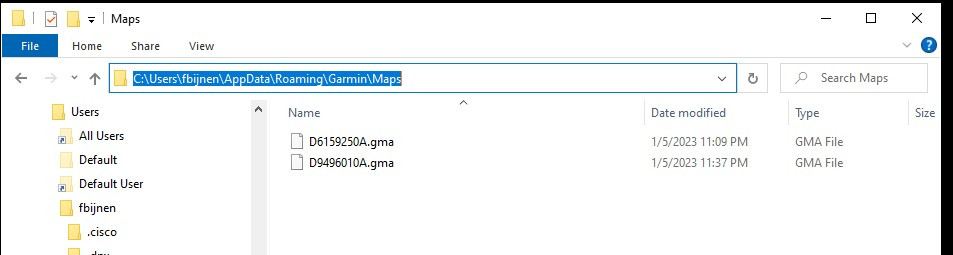

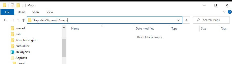

1) Removed ALL codes from my laptop. These are stored in %appdata%\garmin\maps, Just type it in the address bar of windows Explorer. But you can also search for all *.gma files on your hard drive using Windows Explorer.
2) Checked Basecamp. It said that the map was locked.
3) Closed Basecamp.
Did what I posted earlier:

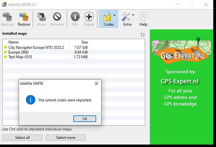

4) Copy the GMA files from the XT to the hard drive.
5) Import it with JaVaWa GMTK
6) Checked the folder from step 1. It now contained the GMA files
7) Started Basecamp and the Map was unlocked.
I don't recommend that you do the same thing, unless you feel you are confident to do this. Especially step 1. This is another way of saying I'm not responsible.
I would recommend to follow Garmin Support directions.

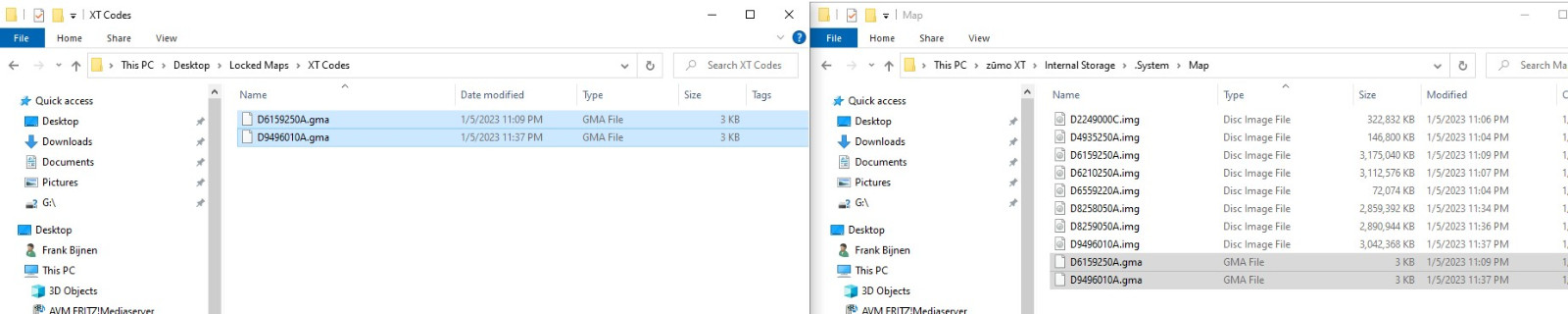

Step 1 Copy codes from XT.jpg (96.62 KiB) Viewed 6323 times

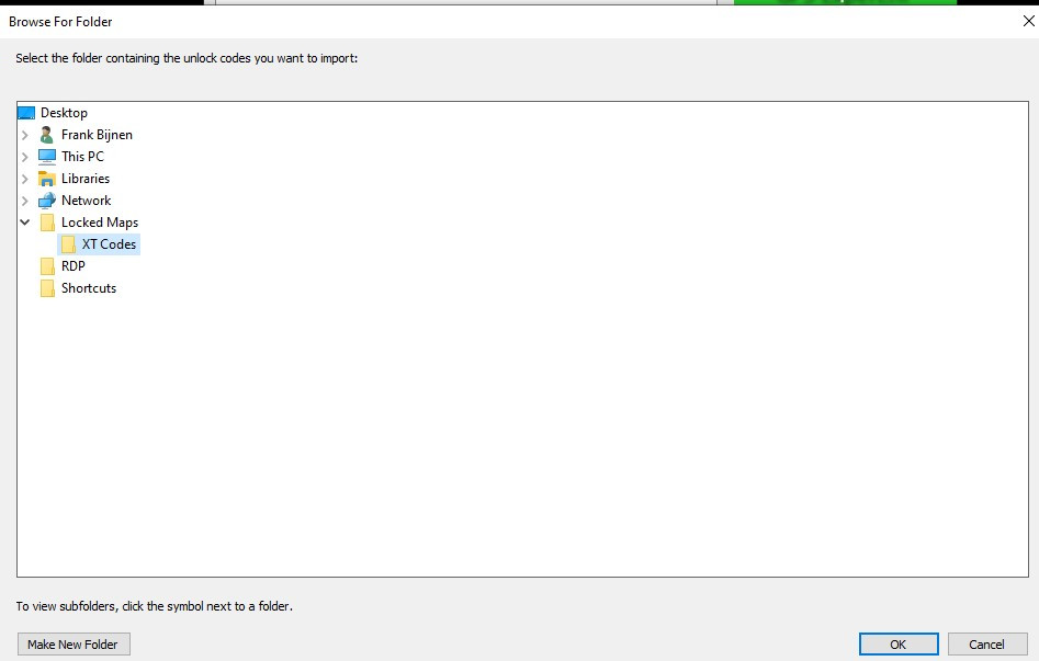

Step 2 Import codes via Javawa GMTK.jpg (76.35 KiB) Viewed 6323 times
Step 3 Choose the folder where the codes from the XT are saved.jpg (46.5 KiB) Viewed 6323 times

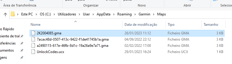

My folder is like this:
Highlighted is the .gma file sent by Garmin Support to me
The other two I guess are for 2022.2 and 2023.1 maps...
Re: Europe NTU 2023.20 map locked on Basecamp
Yes that's the folder.
I do not see the Codes from the XT. I Checked with 2 XT's. My own XT and the one from my son. The files from the XT's are named like:
D6159250A.gma
D9496010B.gma
and dont have those long names...
I would prefer to unlock with the files from the XT.
