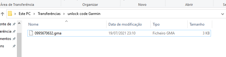

This is the .gma file I copyed from XT and then imported to PC with JaVaWa GMTK:
folder with gma file from XT
code XT.PNG (13.48 KiB) Viewed 5170 times
I notice the date says 19/07/2021 and the file doesn't starts with a letter D ????
Is it possible that the problem is within the Zumo XT that somehow the code is wrong?
Maybe some problem on the instalation and that's why it cannot transfer the map and unlock codes properly to the PC and Basecamp?
Has liked: 202 times
Re: Europe NTU 2023.20 map locked on Basecamp
Not sure if the filename needs to start with D. But the file date is suspicious. If the map on your Xt is not correct, it would explain.

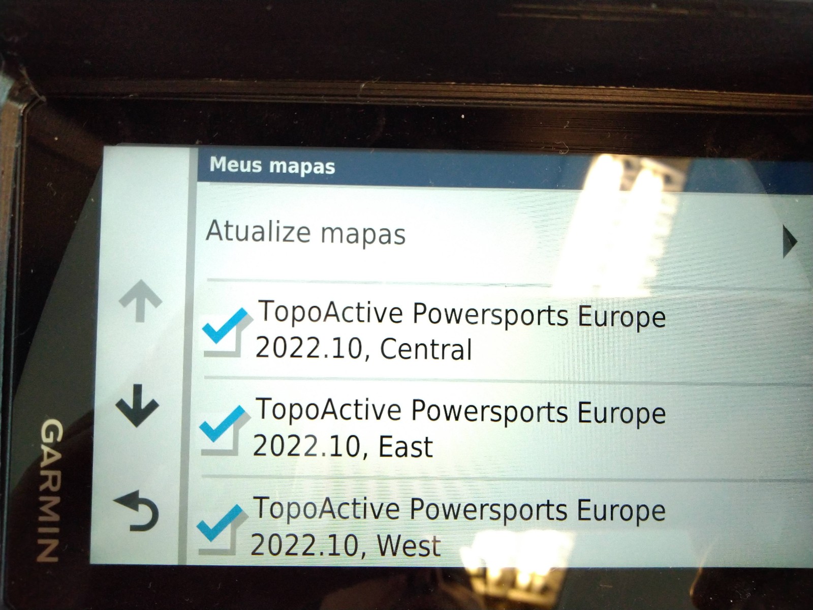

- I installed the .gma file following your instructions on JaVaWa GMTK. I got a message "The unlock codes were imported"
- See bellow these photos from XT My Maps:
Zumo XT My Maps 1.jpg (344.96 KiB) Viewed 5165 times
Zumo XT My Maps 2.jpg (260.16 KiB) Viewed 5165 times
Zumo XT My Maps 3.jpg (342.98 KiB) Viewed 5165 times
- Guess I'll try to reinstall the map on XT! Best way is with Garmin Express button "Reinstall map" on Map Details I guess?
Thanks for all your patience on this.

The maps on the Xt look good. But what I dont understand. I think you should have 2 GMA files. At least I have 2 GMA files and have the same maps as you.
It made no difference, on your PC, after you imported the GMA File I assume?
Yes, reinstall with Garmin Express.

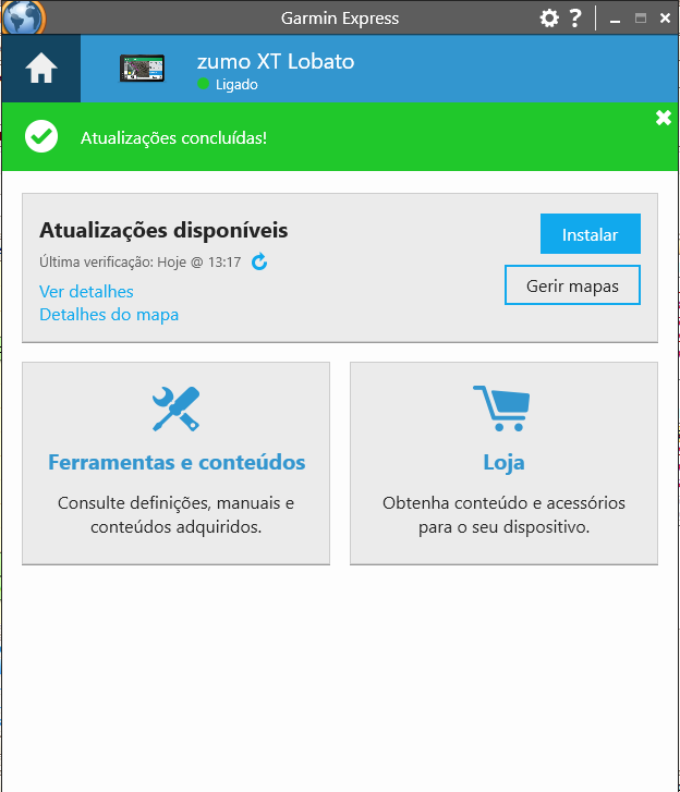

I reinstalled the map on Zumo XT. Everything went ok:
Zumo XT map reinstall.PNG (48.97 KiB) Viewed 5154 times

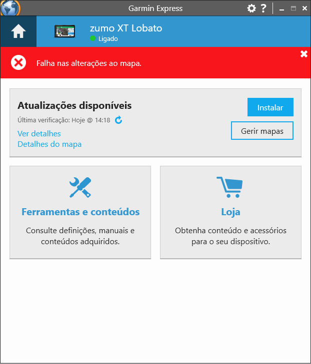

I then installed Europe 2023.2 map on Basecamp PC. Got again this message at the end:
Basecamp map reinstall.PNG (45.3 KiB) Viewed 5154 times
