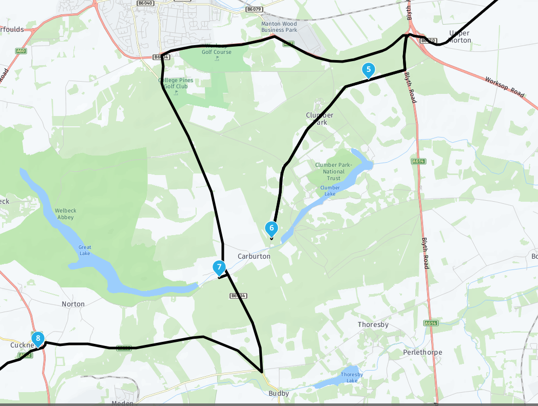

I am planning a trip through MyRoute App and this is the route I want to take which is planned using TomTom's routing
2022-07-11 10 01 52.png (411.06 KiB) Viewed 2213 times
And this is what I get using Here maps which is used for routing the same as what your Garmin would do
2022-07-11 10 01 03.png (341.84 KiB) Viewed 2213 times
If Garmin want to be the leader in Motorcycle navigation then I really think they need to up their game

The route produced by the Here map appears to have used a "Faster Time" algorithm. It routed as if either it detects a road closure between points 6 & 7 or its algorithm determined that getting through Carburton would be slow (I would assume this if the route had been created by the XT).
Posts: 1024
Has liked: 436 times
Been liked: 264 times
Re: Route planning frustrations!
Peobody wrote: Mon Jul 11, 2022 1:04 pm The route produced by the Here map appears to have used a "Faster Time" algorithm. It routed as if either it detects a road closure between points 6 & 7 or its algorithm determined that getting through Carburton would be slow (I would assume this if the route had been created by the XT).
Its treating it as though the road is a no through road!
Point 5 and 6 are there to force the route down that road
TomTom and google maps allows you to go through with no issues
Strange. Plotted in BaseCamp using the driving profile there aren't any issues, only a strange route if you select the motorcycling profile. Even the RV profile routes correctly.
Posts: 2124
Been liked: 560 times
Stu wrote: Mon Jul 11, 2022 1:16 pm TomTom and google maps allows you to go through with no issues
I know. I have never done TomTom but have seen this behavior in BaseCamp and on the XT. We don't have any choice but to deal with the idiosyncrasies of each map and routing software. We can rant about it though (I've done my share of that).
Posts: 2124
sussamb wrote: Mon Jul 11, 2022 1:52 pm Strange. Plotted in BaseCamp using the driving profile there aren't any issues, only a strange route if you select the motorcycling profile. Even the RV profile routes correctly.
I certainly would like to understand why the motorcycling profile produces a strange route. The big question is whether motorcyclists would be better off using the Driving profile, and/or what setting in the motorcycling profile results in a different route than the driving profile.
