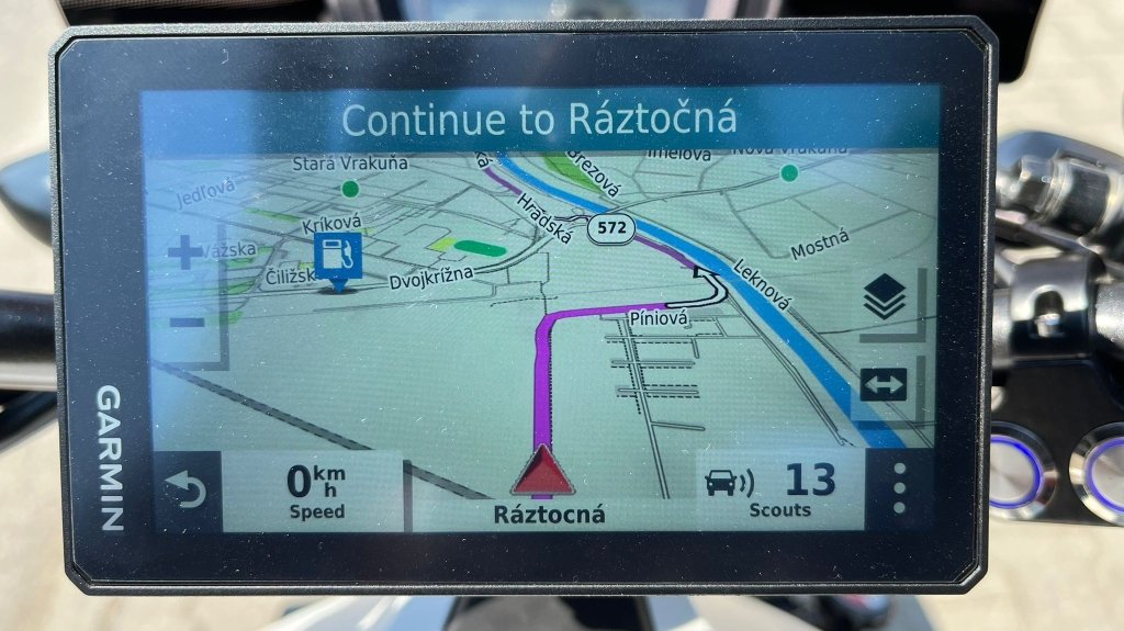

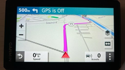

Hello all there, I''d like to describe you mine issue. This is not only mine, more users reported this on FB groups.
On the navigation screen you have blue info bar (ribbon) on the top of the screen. There should be current important infos about next junction, turn, roundabout exit... But I have there empty bar, or just info with the text "Continue on <name-of-street>" or "Continue on road B54". I have all updates, no custom maps, I've been trying to disable layer, topo maps... Only disabling GPS and simulate the trip - than it shows actions correctly.
Some example screenshots:
Enabled GPS on Raztocna - only Continue shows:
Disabled GPS on Raztocna - show next turn:
Next example is empty action:
And with GPS off:

Hi, friend of mine tested it today and he has not problem. But after he performed maps update (ignored until now), the problem raised as well.

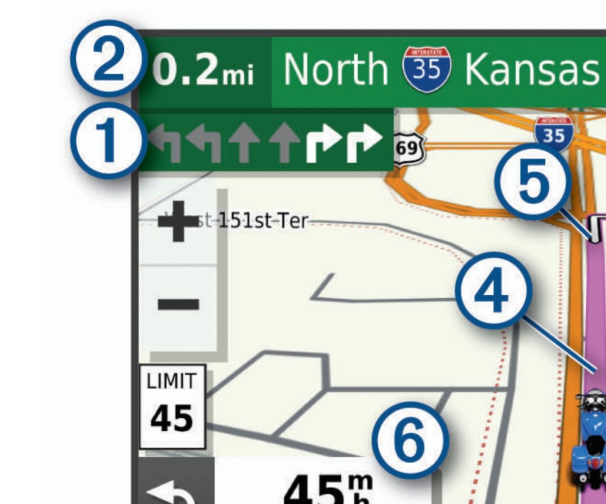

I am now having the same problem since a recent update. I'm not sure if it was an update to the firmware (6.50) or the last map (CN North America NT 2023.10) that caused it.
The upper green text bar no longer shows the next action in the route, 1 in the image below, or distance to the next action in the route, 2 in the image below.
Garmin-next actions.jpg (119.75 KiB) Viewed 4315 times
Has anyone else experienced this and if so how was it solved?

Thanks for the suggestion, but the 3D image I showed is not from my screen but rather from the Garmin XT manual. I used this to show the items that are missing from my screen.

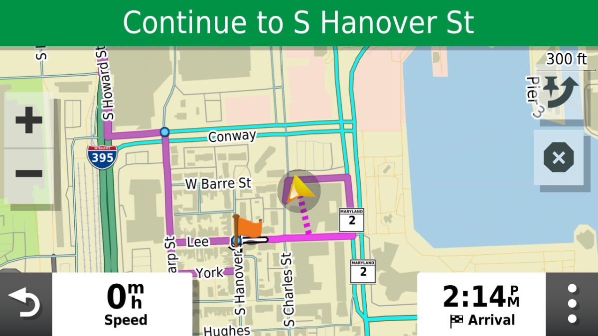

Here's a screenshot of my unit. Note the lack of next turn info. I used to have this.

Have you update your XT? So then a soft or master reset can help.
PS: What is the different between a green or a blue bar????

Normally 'Continue to xxxx Street' is displayed when you are NOT(!) on the planned route ant therefor you get no 'next turn info'! These are only displayed when you're on the planned route...
