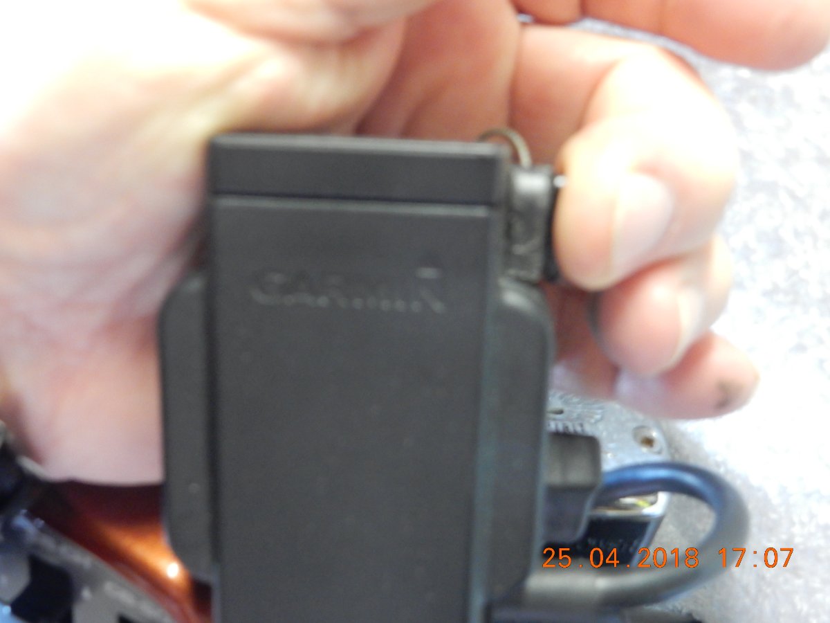

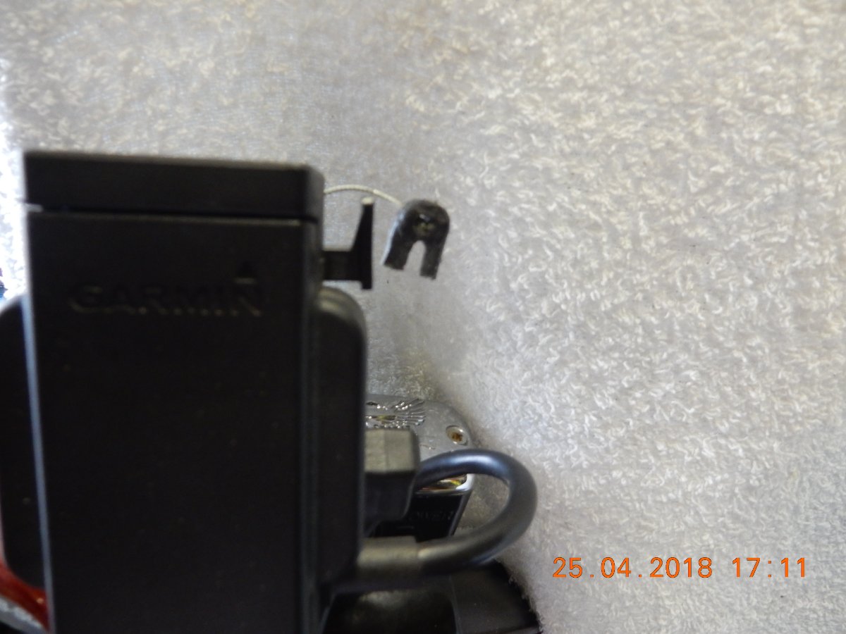

I made this simple device to act as a detterent. As seen in the photos it prevents the release button being pressed meaning the Zumo or dust cover cannot be removed from the cradle. It also prevents the GPS from being accidently released while you're travelling. Seems unlikely but I have heard of it happening at Motorway speed :o It obviously would not stop a determined thief but may stop someone taking the unit if you leave it on the bike whilst paying for fuel. (I've heard of that happening as well) :evil:

Another piccy with the lock in place.

What stops someone just lifting the thingy off and then pressing the button?

It's never gonna make it thief proof Alan but when it's clipped in place it should (hopefully) deter someone who's not familiar with the release button. If nothing else, it will stop accidental release from the cradle when on the move.

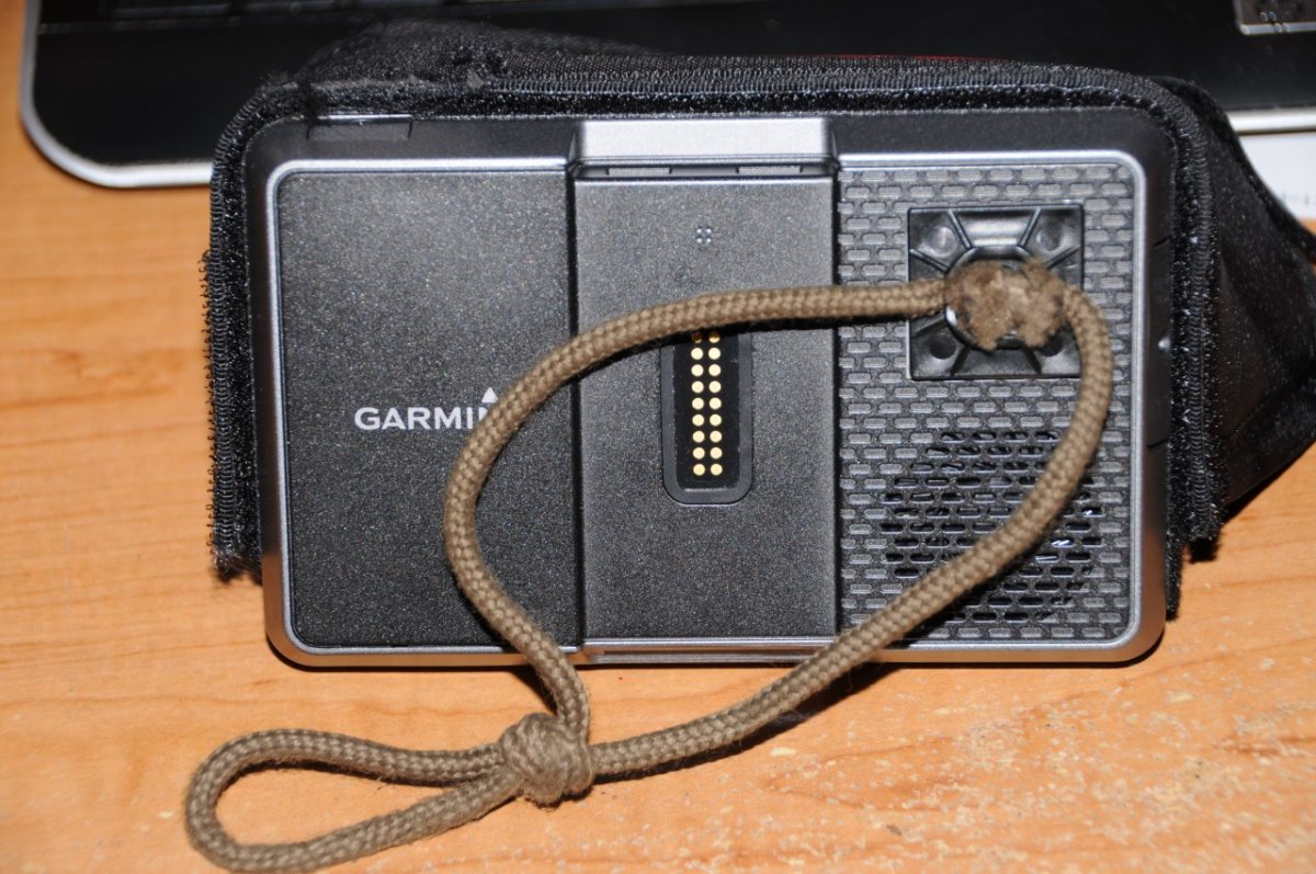

Security Loop.jpg (201.08 KiB) Viewed 38154 times
Keeps mine from falling off the cradle. Easy to remove and put around my wrist while inside a quickie mart. More secure than a cradle lock that a 1" prybar may unlock.

Looks good dave. Is that a self adhesive pad?

Self-stick zip-tie mounting tab. I saw something similar years ago that someone posted. The finger hole in the boot lace was my idea as it makes it faster to loop securely over cradle and down to the bottom ball socket on my handlebars before snapping the Zumo into the cradle. Tight fit around my wrist, but that's good so it doesn't slip off. The front side has a RBNS HOODS $30. to cut down on sun glare.
