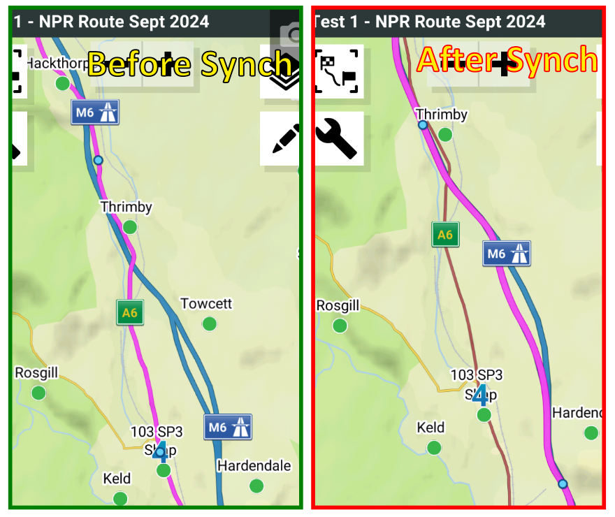

Imported Routes on the XT2
Imported routes tend to become altered on the XT2 if they are synchronised via the Tread App on your phone.
Here is an example of the problem. The route one the left is what I planned and sent to the XT2 as a gpx file on the SD card.
This route stays like this - as long as it isn't synched with the Tread App. As soon as it synchs, then it changes the route and moves the shaping points.
A few of us have reported this to Garmin - but please, if you come across it then report it as well. THe more they realise that it is a big problem the more chance that they might do something about it.
In the meantime - a working solutions seems to be that:
For the Android at least, the Tread App is still available for relaying weather, traffic, road works, messages etc to the phone in thsi state. I am unable to test that aspect of it on an iphone.
It remains to be seen how effective this is on a ride -- eg whether or not the XT2 can also be responsible for moving shaping points.
- If the Tread App is swiped off the phone screen, then the XT2 can no longer synch with it -so the route remains intact.
