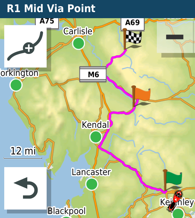

Pic 1 Below. The original route.
This is exactly as the route was transferred from BC and imported into the Zumo. The maps are the same, the vehicle is the same. The route does not get recalculated by the Zumo in these circumstances. This is exactly how it was plotted in Basecamp.

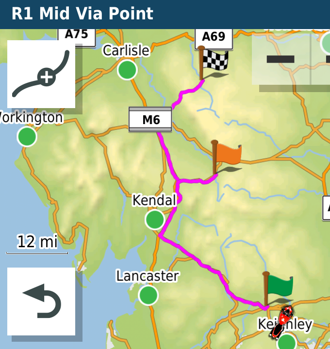

Pic 2 Below. After a forced recalculation
I changed the vehicle to off road, and then changed it back to motorcycle. This forces the route to be completely recalculated, and for that it uses my riding profile, Faster Time and no avoidances. The route in Pic 2 above now takes the A65 road NW towards Kendal - heading for the M6 motorway. It then leaves the motorway for the A686 to get to the Via Point (at a town called Kirkby Stephen). And then continues on A roads - NW then NE to the finish flag at Alston. It does not revisit the M6 motorway again.
This route is OK - I would expect the XT to head for the motorways - to reach that first Via Point. To get to the second via point it still uses the major roads in this case, the A66, before taking the only road from there to the finish flag at Alston. It's not the way I would tide, but the route is a logical choice.

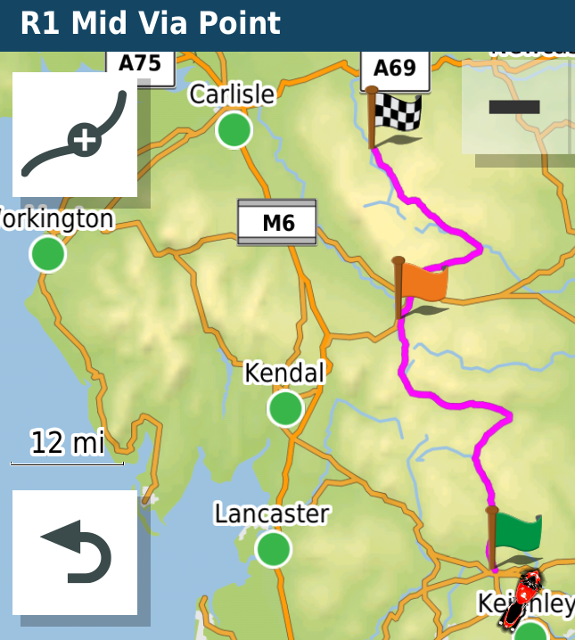

Pic 3 Below. After changing the Via Point to a Shaping Point.
The mid point was moved by the XT when I changed it to a shaping point - but in this particular example it made no difference to the outcome of the test. I did the same test with a route straight from Basecamp with the shaping point in exactly the same location as the original via. it produced the same result as shown in Pic3 after recalculation.
The route in this case is identical to the route after the Zumo had recalculated the original. Yay. Result.
