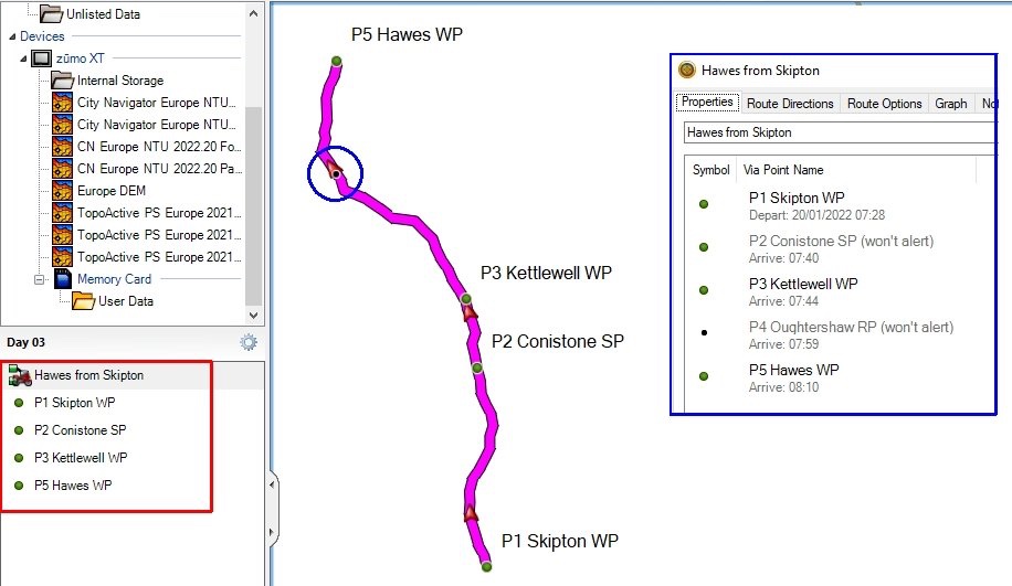

See if pictures help .....
In Basecamp, you create a waypoint with the flag tool.
When a route is selected in Basecamp, if a point on the route is not listed in the bottom left corner, then it is not a Waypoin
In the picture below:
Waypoints are listed in the widow outlined in red.
P1, P2, P3 and P5 are Waypoints.
P1, P3 and P5 are Via Points
P2 and P4 are Shaping Points.

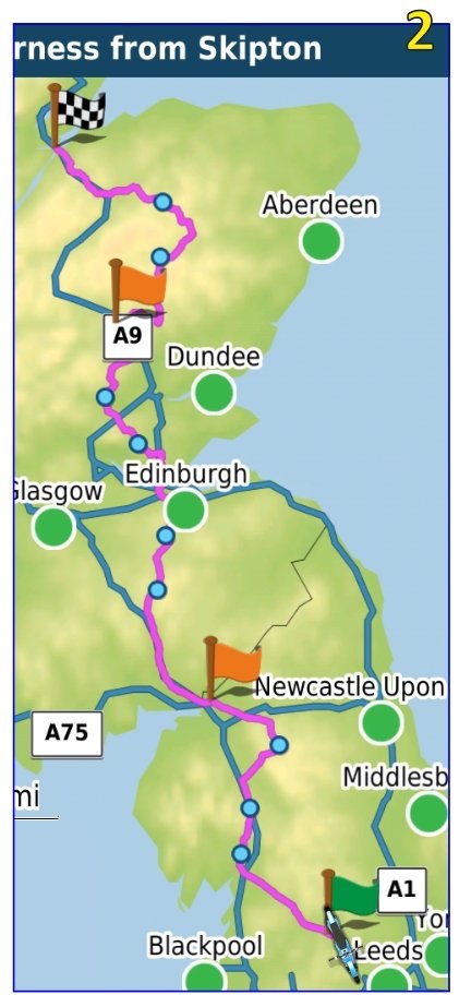

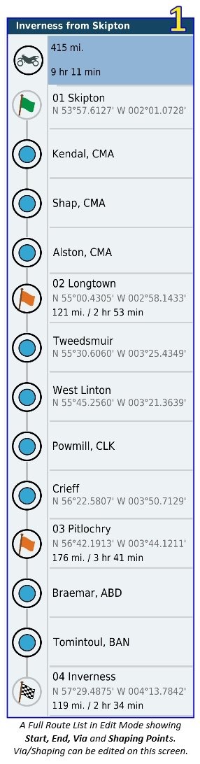

[b)A different route. The 2 Pictures Below show 2 screens of the Zumo XT[/b]
I can see 4 Via Points including the start and finish.
I can see 11 Shaping points.
I cannot tell from either of these screens which ones are also Waypoints.
