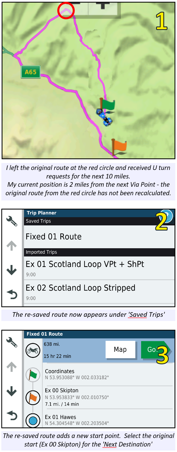

What is RUT Behaviour ? In certain circumstances the Zūmo XT seems to get 'stuck in a rut', of repeatedly asking for a U-Turn. It is trying to get you to go back to the last point when you were on its recalculated route. This will be behind you if it has already asked you to turn back. The same behaviour happens if you disable U turns - except it finds side roads to get you to turn back - so there is usually a longer gap between requests, At least the repeated U turns give you a clue that something odd is happening.
Pic 1 - is a real example. I am at the green flag. The magenta line is the route that the XT has calculated to get me to orange flag. 28 miles to reach a via point less than 2 miles away.
If I create the same route on the XT Trip Planner App, or if I use this same route and 'fix' it using one of the methods described below, the XT does not do this. Instead it does what I would expect: as soon as I turn away from the plotted route at the red circle, it immediately calculates a new route - in the direction I am heading.
When Does it Happen ? It only happens with imported routes, never on a route created entirely on the XT. It seems to be initiated when the XT recalculates the route. eg when using 'Skip'
Subsequently, RUT behaviour happens if I deviate from its route. It seems to want me to return to where I first left the route. Note that repeated demands for U turn do not by themselves indicate RUT behaviour. But if it continues, when the way ahead is clearly the best way to the next route point, then it seems likely. There are other symptoms that can prove it.
