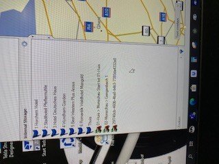

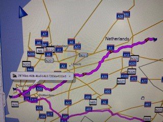

It seems my XT has a ghost route in the system. I can't find it in the XT or memorycard but when i connect the XT to basecamp on my windows computer there is a ghost route. Because i can't see it in my XT it is not possible to remove it to the trash. somebody out there who can help me?? I restored my XT allready

Unfortunately you can't delete via basescamp what is on the XT.
The wrong route is not to be found in Garmin Explore

If you connect your XT to the PC and look at the files on it. There is one in the GPX directory called temp cache or something like that. I found deleting it gets rid of unwanted routes.
The only other way was formatting the SD card. Which is annoying as it means losing all my music. (Did it in Spain a couple of weeks ago. Had to ride 1000 mile day with no music)
Re: Ghost route in my XT
If you've sent routes from BaseCamp then yes, there will be a file named temp.gpx
Once the routes are on your device it's generally a good idea to delete temp.gpx
