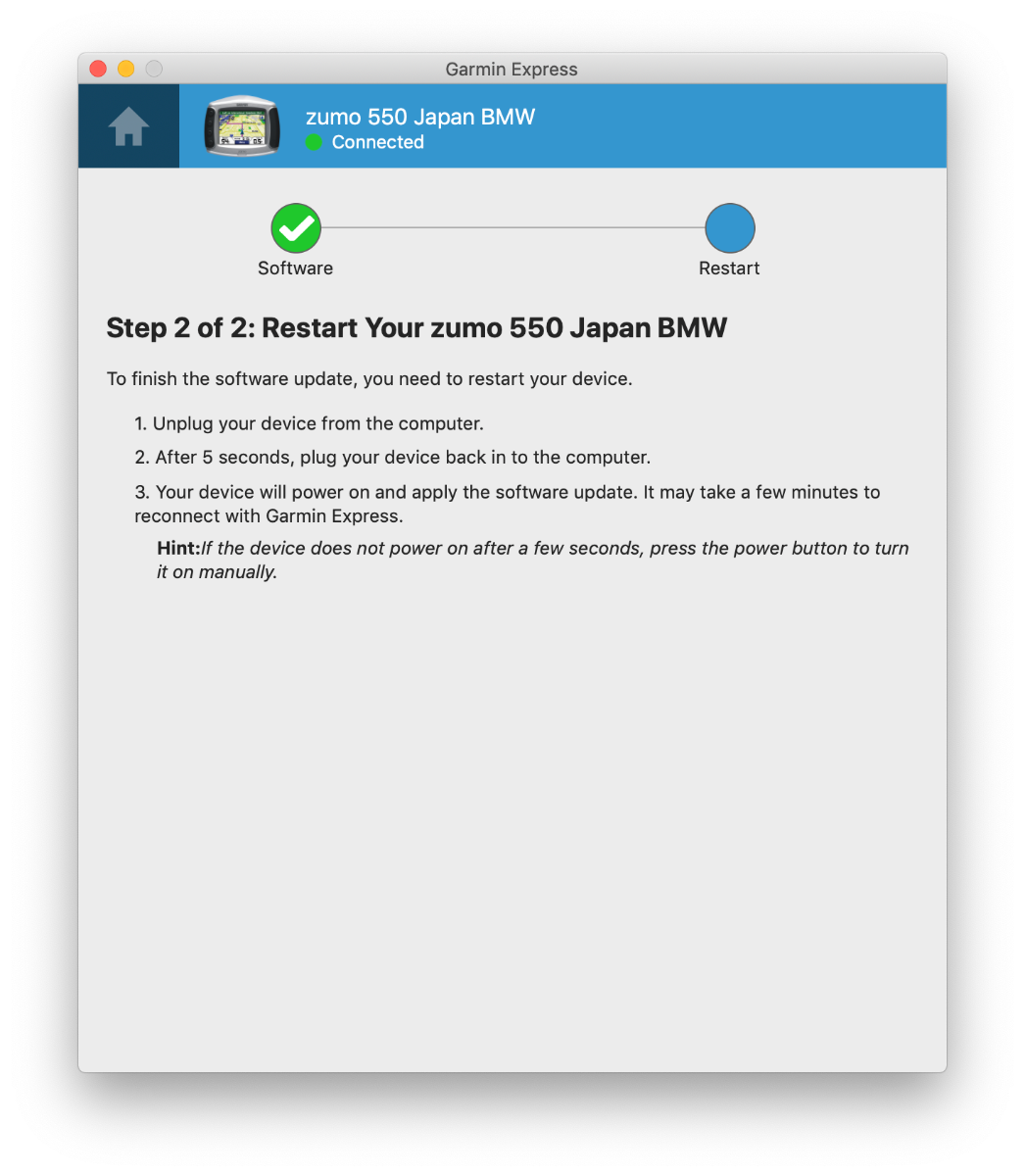

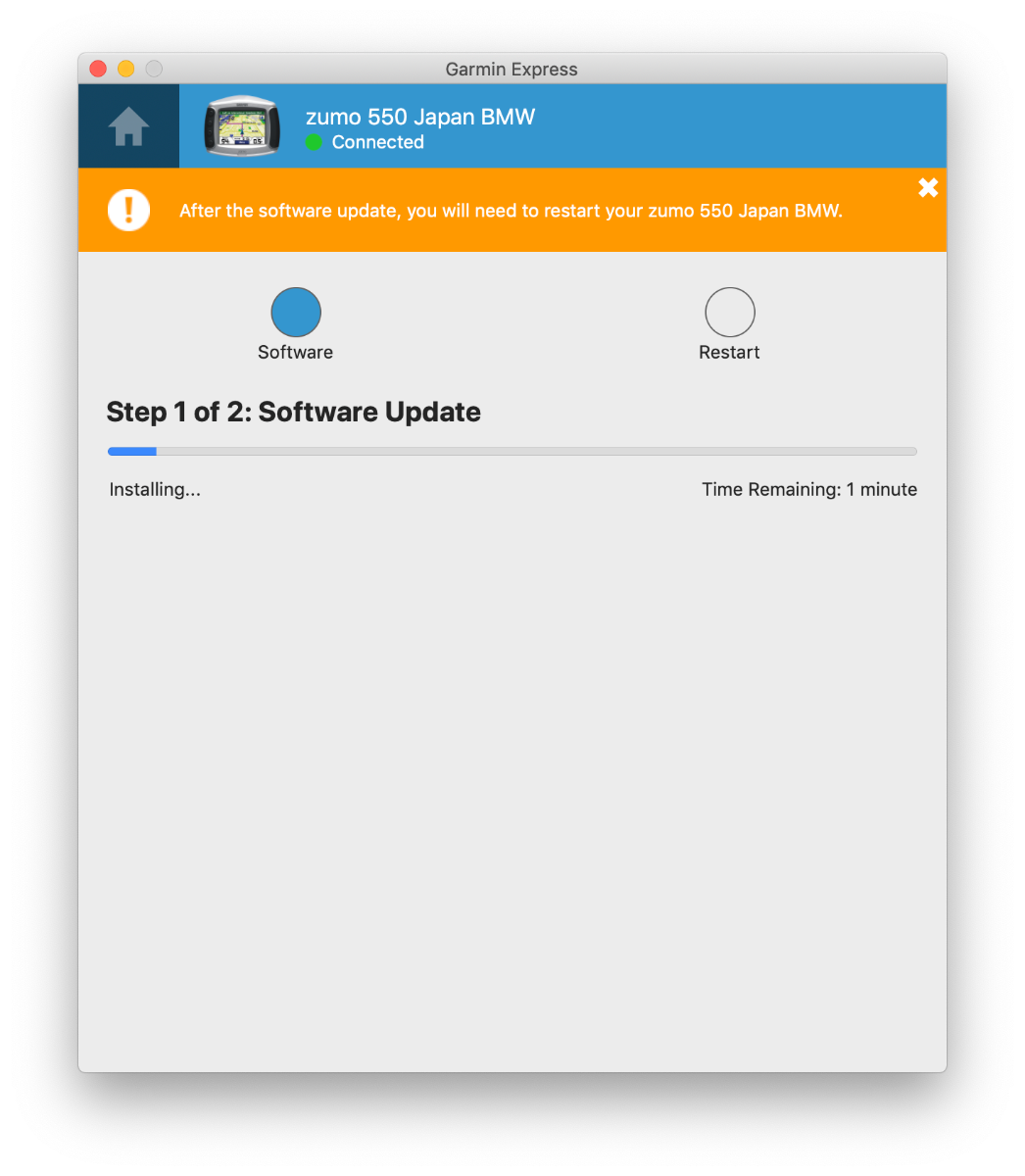

This is my update process:
Step 1
Step 1
Screenshot 2020-06-23 at 21.34.15.png (585.19 KiB) Viewed 4510 times
Step 2
Step 2
Screenshot 2020-06-23 at 21.34.40.png (301.35 KiB) Viewed 4510 times
Step 3
Step 3
Screenshot 2020-06-23 at 21.35.26.png (352.18 KiB) Viewed 4510 times
I've completely followed the instructions from the last step. The device was disconnected and connected again after 5 seconds. I didn't see any update process after that, just regular plugging process to my laptop. After that I could open mass storage and see the GUPDATE.GCD in the Garmin folder. Garmin Express still showed me the last step (last screenshoot). I've tried to wait some time, tried to reboot, but it didn't help. I still see ver 3.15 in preferences.

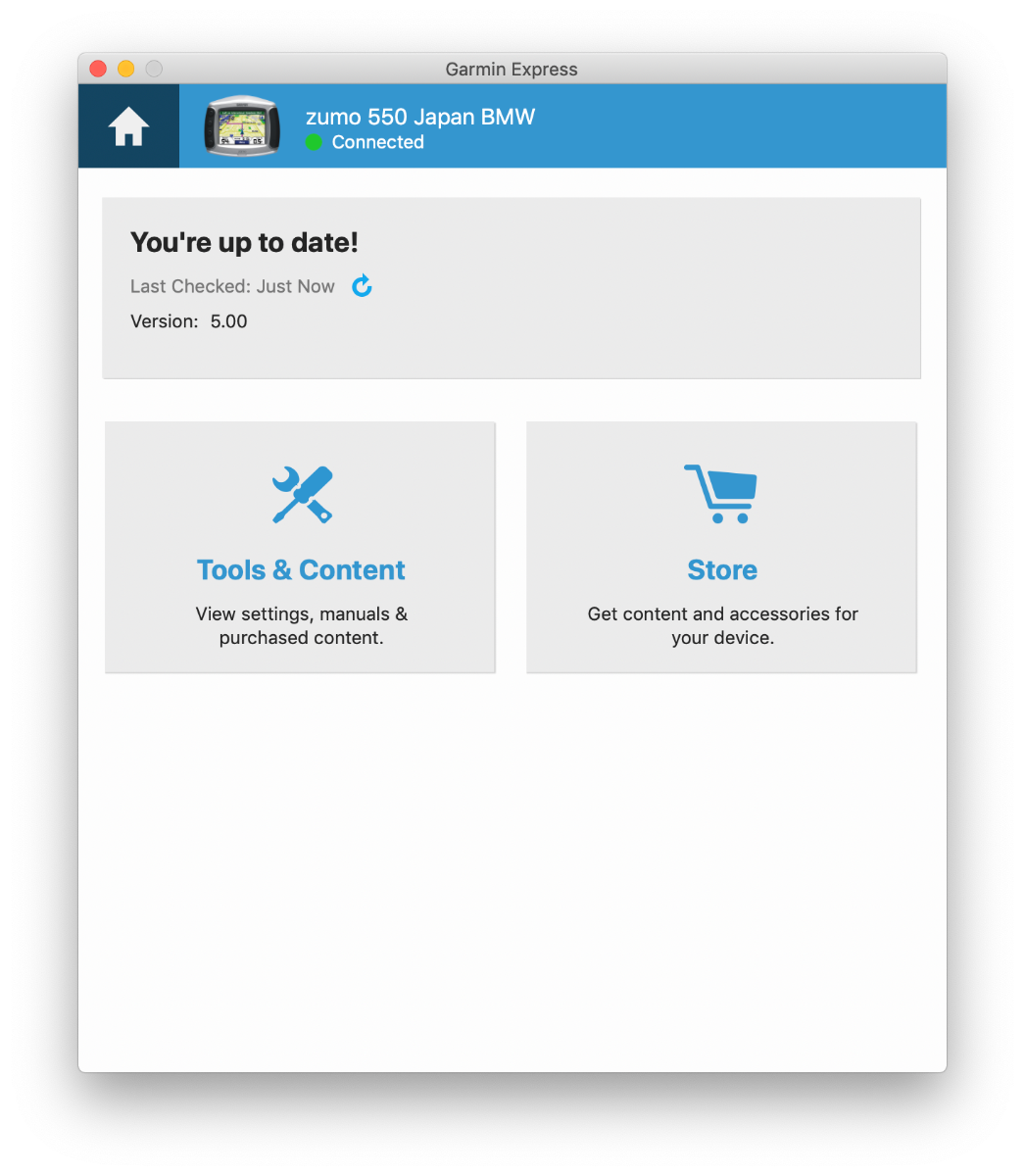

Btw Garmin Express shows me:
Screenshot 2020-06-24 at 12.51.32.png (564.2 KiB) Viewed 4486 times
(GarminDevice.xml still contains 315, and also the same in device preferences)

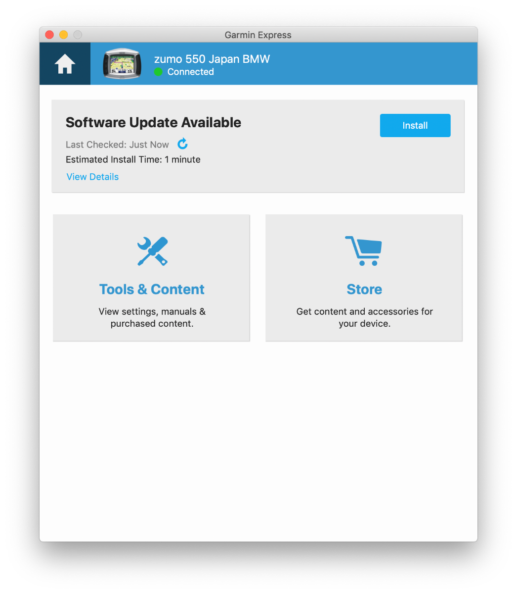

But if I delete the device from Express and add it again, Garmin offers me to update from 3.15 to 5.0 (like in screenshoots from my previous post)
