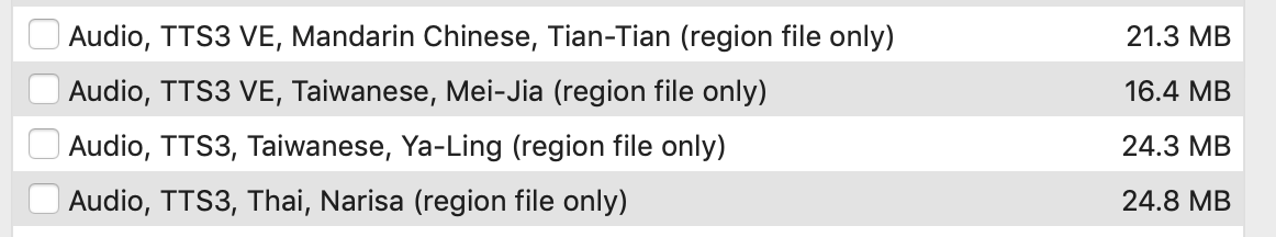

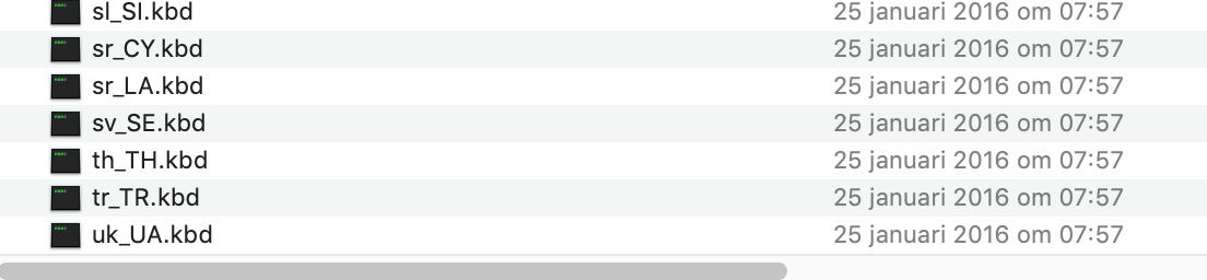

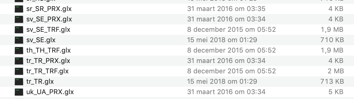

Re: Can anyone confirm if EU 595 eu model support Thai keyboard, font and speak?
One is text, one is keyboard, and in Garmin Express can you find the different Tai languages.
- Schermafbeelding 2019-08-22 om 13.57.02.png (84.47 KiB) Viewed 3043 times
- Schermafbeelding 2019-08-22 om 13.57.19.png (55.16 KiB) Viewed 3043 times
- Schermafbeelding 2019-08-22 om 13.58.22.png (44.87 KiB) Viewed 3043 times
