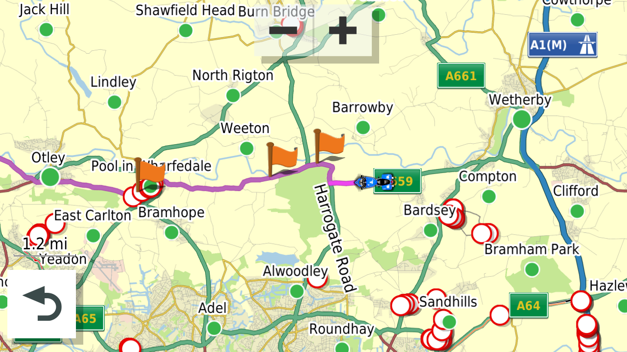

i)Settings->Driver Assistance and then - Speeding Alert / Reduced Speed Tone / Proximity Alerts
ii)Settings->Map Display->Map Layers->Traffic also Up Ahead Places is an option for red light cameras.

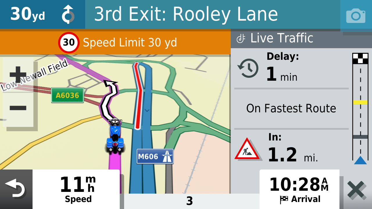

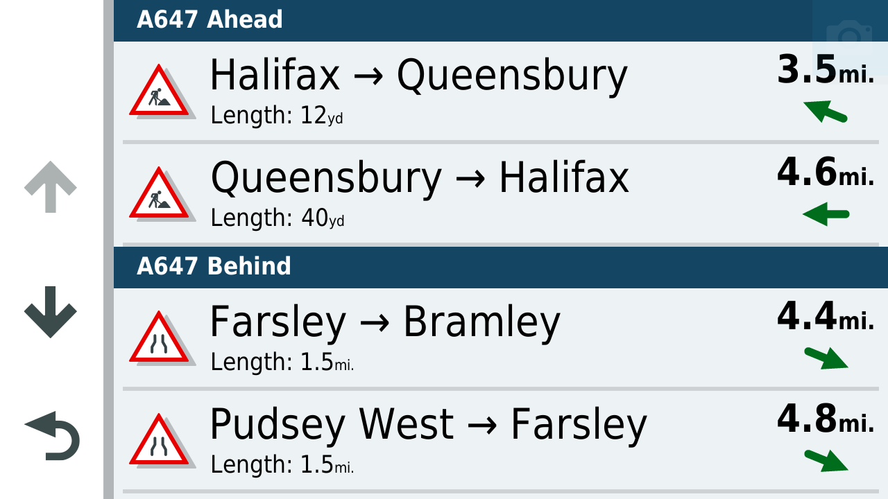

But you can use the Zumo map to browse for traffic and road closures, and you can get a display on the right hand side of the screen showing traffic issues ahead on your route.
The roads are colour coded to show where there are delays - but only at certain zoom levels.
Take a look here. These were obtained on the Zumo XT, but I have just checked and managed to get very similar displays, using very similar option on the XT2.
You have to wait quite a while for it to collect this amount of data, so give it a few minutes. On the road, I find that if you have displayed the traffic info at the right hand side and it says no-delays, then that isn't updated as quickly. If you close the view down and then open it up again, it seems to force a refresh. That's not an issue - becasue it might take you 20 minutes to reach particular traffic problems, and it will have updated easily in that amount of time.
I've attached a couple of screen shots, but the link has explanations and many more screen shots.
https://www.zumouserforums.co.uk/app.php/ZXT-P54a
