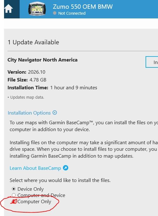

MSTOCK27370
Posts: 231
Has liked: 22 times
Been liked: 44 times
Re: "Files Too Large" for update
Post by MSTOCK27370 »
gbyoung2 wrote: Wed Mar 19, 2025 6:15 pm
The "Computer Option" doesn't appear in my version of Garmin's Express, version 7.24.0.0,and that appears to be the latest version. FWIW, I'm running Win 11
I am running 7.24.0.0 and the Computer Only option is there. I thought that issue only applied to the XT2.
Michael S.
