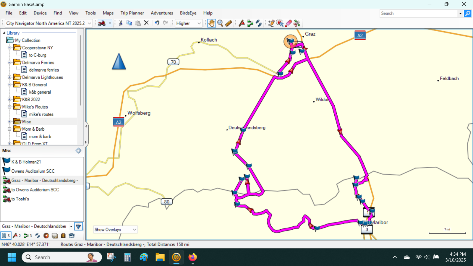

I downloaded the route, here's what BaseCamp shows for me
Screenshot (1).png (539.26 KiB) Viewed 2463 times
Zooming in I see normal up and back roads in the bottom left. Your profile is Motorcycle-Curvy Roads, my BaseCamp didn't like that. I never use the curvy road choice, I found it too glitchy.
