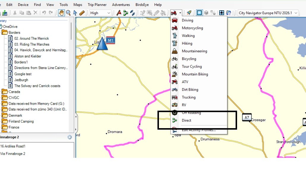

Windows. But make sure you don't have this selected in Global settings.
