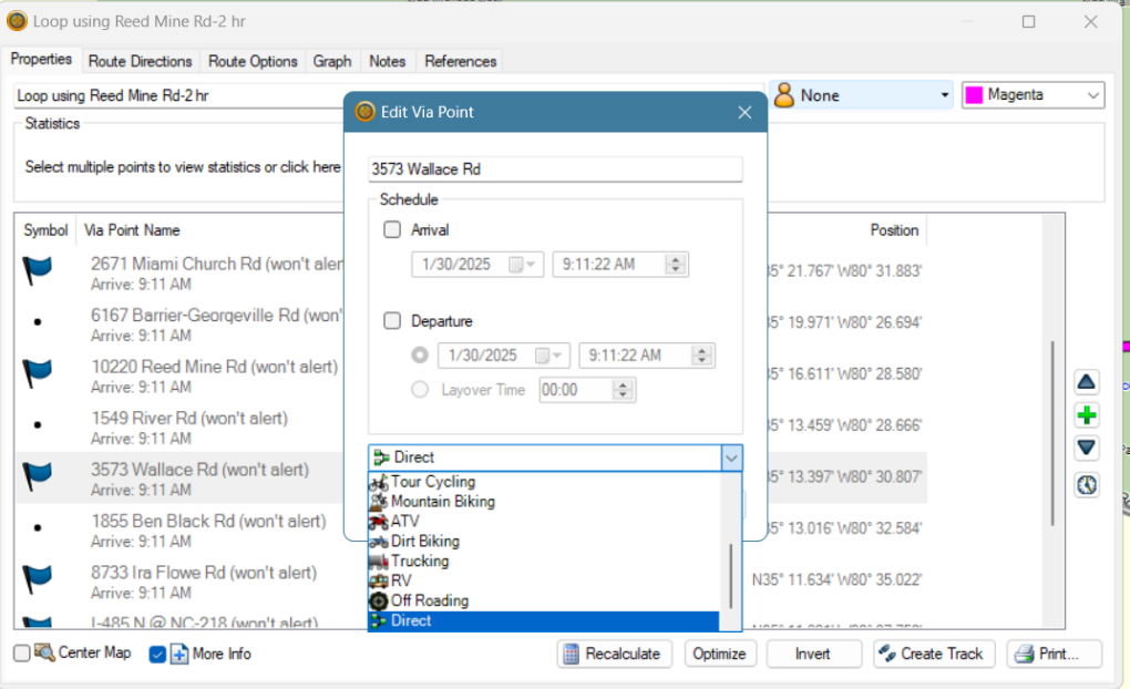

Oh, while at it, have you ever got a straight line after importing into the BC? Usually I am correcting it in the Route properties by moving 2 points around and x-out. Now it would follow the route (not always though), so I go there again and correct them back. But why it brings it as a straight line to begin with?

Perhaps the leading route point is assigned the "Direct" activity profile. Each route point can be assigned its own Activity Profile. When one is assigned the "Direct" activity profile, the leg from it to the next route point will be a straight line. This image shows where that option is.

Fxwheels wrote: Thu Jan 30, 2025 2:24 am Usually I am correcting it in the Route properties by moving 2 points around and x-out. Now it would follow the route (not always though), so I go there again and correct them back. But why it brings it as a straight line to begin with?
Use the Recalculate button at the bottom of the Properties box if it initially shows straight lines.

Both options worked!
