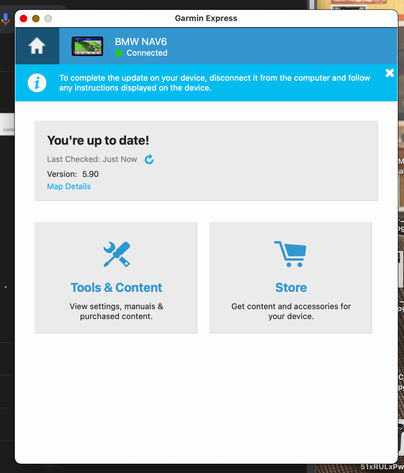

Also, why doesn't my apple computer see the XT2 when I plug it in? Garmin Express see it, but not the computer. How do I copy and GPX file is the computer doesn't see it?

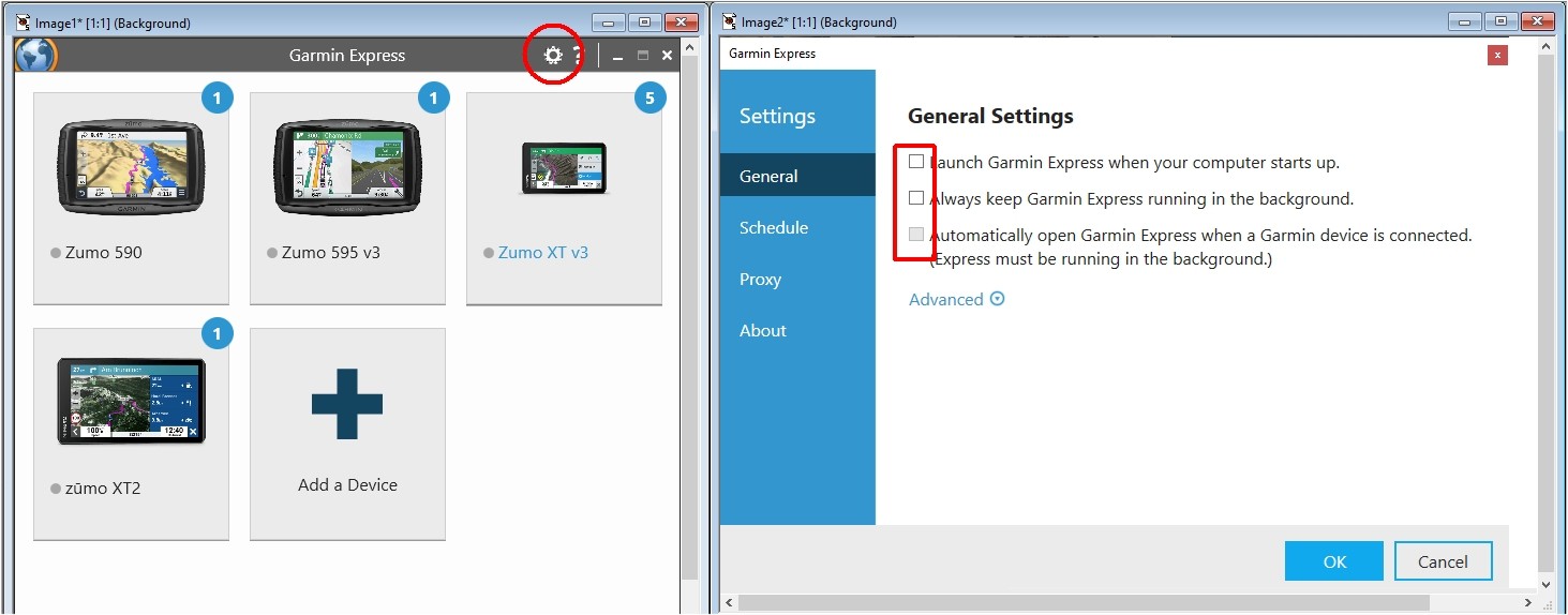

BC never did like to have Garmin Express running. And Express likes to load up when you start the computer. Two things:Frogman1 wrote: Tue Jul 30, 2024 9:30 pm Also, why doesn't my apple computer see the XT2 when I plug it in? Garmin Express see it, but not the computer. How do I copy and GPX file is the computer doesn't see it?
1. Stop Garmin Express running in the background - use the gear icon, select General and untick the 2/3 tick boxes.
2. Then close down Express.

I open express, but where is the gear icon? Does the XT2 need to be connected? Help

Right side of the window title bar, next to the help question mark and the minimize/maximize/close icons.Frogman1 wrote: Tue Jul 30, 2024 11:30 pm I open express, but where is the gear icon? Does the XT2 need to be connected? Help

Click the image to see a larger pic.
Gear icon circled.
Untick all of the boxes.

Re: BASECAMP AND XT2
I did what it said and unchecked, now how do I know it's off?
