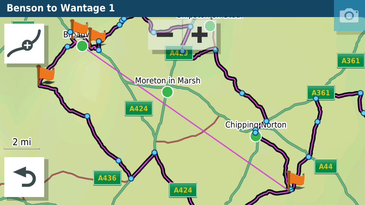

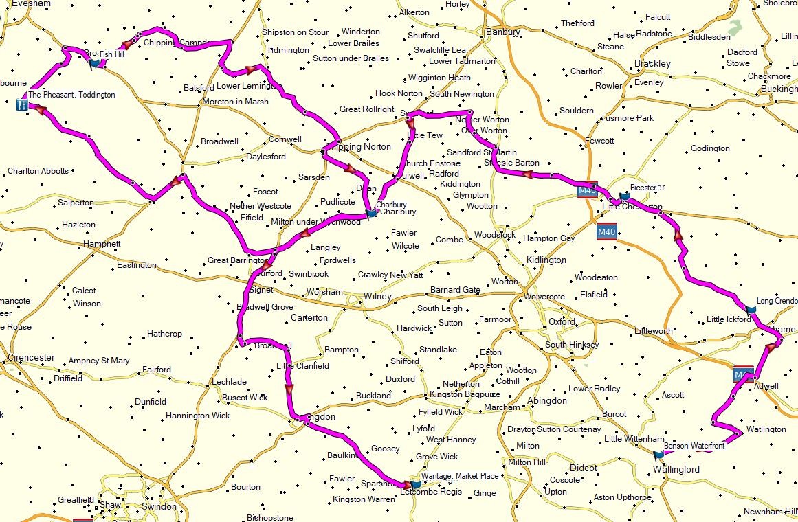

I've created a route in Basecamp and transferred it to my XT. The route shows as intended in Basecamp but one of the waypoints moves 25 miles away to show in the wrong part of the route, joined with a straight line cross-country.
Basecamp:
XT:
The waypoint at Charlbury is actually included in the route twice. The first pass through it was correct, however after completing the loop and approaching Charlbury for the second time the XT directed me to leave the road and ride in a straight line for 25 miles as it now thought the waypoint was 25 miles away. You can see the extra flag at the top left of the screenshot. Maybe it's something to do with having the same waypoint twice in the route. I've tried uploading the route again and it does it consistently. Anyone seen this? Any suggestions to avoid it?

Jomo wrote: Tue May 21, 2024 9:42 pm The waypoint at Charlbury is actually included in the route twice.
The XT has problems with waypoints included multiple times in a route, see: viewtopic.php?p=17656&hilit=import+route#p17656
You could try to duplicate and rename the waypoints so their names will be unique. (E.G. Charlbury_1 and Charlbury_2) Remove the original ones from the route and add the newly created.
