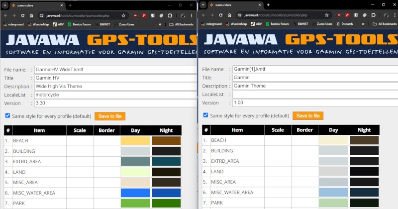

OK, let's try this. Make a list of the duplicate/triplicate themes that you see in the XT menu, so you know what TITLEs to look for. The theme filenames are all unique, so we will be looking into the files to fix the ones with duplicate TITLES.
Connect the XT to the PC via USB. In File Explorer, navigate to zumoXT/internal storage/themes/map. Left-click and drag that entire Map folder over to your Desktop. (Trying to edit a theme on the XT with NotePad or JaVaWa will require extra steps).
Go to https://www.javawa.nl/zumocolors.html. Click the "Select theme file button". Navigate to the Map folder on your Desktop.

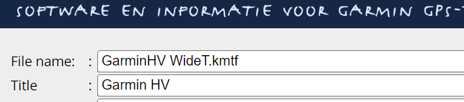

Look at the file dates on the .kmtf files. Open the first file newer than 2019. (Anything with a 2019 date is probably an original theme and can be ignored for now.). Click the Edit button.
The top two lines will show the file name and the Title of the theme. These are the only two lines you need to look at. If the TITLE is one of the duplicates, and is the same as the filename, leave it alone. Go back a page and select another file to edit.
If the TITLE is a duplicate and is different than the filename, change it to match the file name (without the .kmtf extension), and Save the file.
Look at all the remaining theme files in the same way, correcting the titles as needed.
When complete, drag the corrected files (with todays date) from Desktop/Map back into zumoXT/internal storage/themes/map, overwriting the files with the same name.
Each theme should then have a unique name in the XT menu. You can try each one and decide to keep it or not. Reconnecting to your laptop and deleting the corresponding filename will remove it from the menu.
