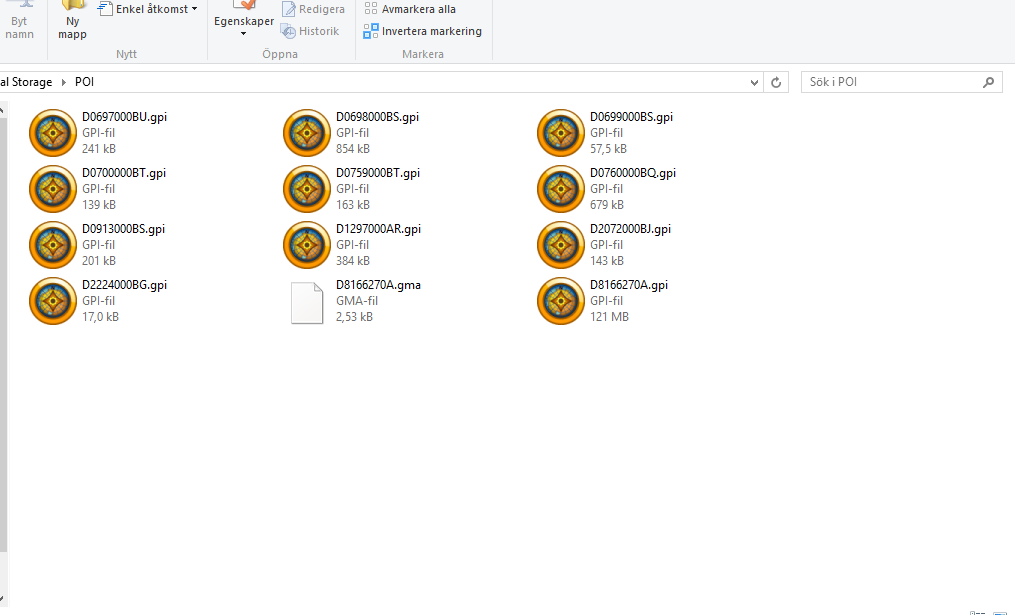

I think i got a clue from the scdb site. I must delete the "cyclops" cam file, because the garmin can not show poi:s both from the scdb and preinstalled at the same time. BUT... can anyone say which ones are the speed cam file?
Skärmbild (495).png (63.36 KiB) Viewed 1291 times

Re: Can not get cams to show up on map..
There is probably a better way, but I usually take a peek at the files with a good text editor. (For windows - Notepad++)
There is usually some clear text in the first few lines that tells me what is in the file.

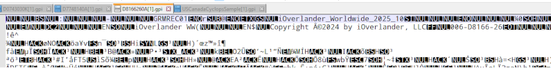

lkraus wrote: Sat Apr 13, 2024 10:27 pm There is probably a better way, but I usually take a peek at the files with a good text editor.
Thank you! That worked. All speed cam files, except one.
I deleted the original ones from the XT, but the new ones still doesnt show up on the main map. They are under "my POIs", and when i click "show on map" from the POI menu, then everything is visible with icons and all. But not on the main map or after making a route.
