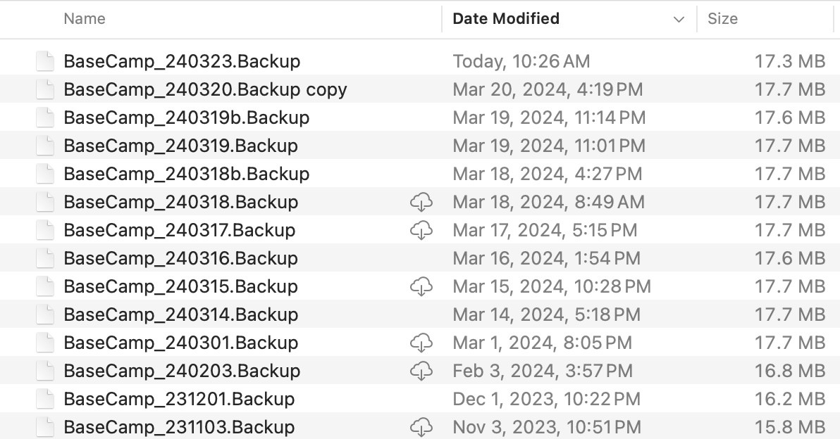

It has worked well for me for a number of years (on Mac), just need to be methodical about backing up each time you add data, at least if using on more than one computer, may not be an issue if ONLY using for backup as you may not restore database often.
