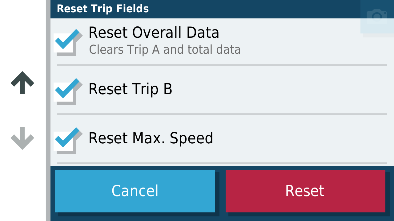

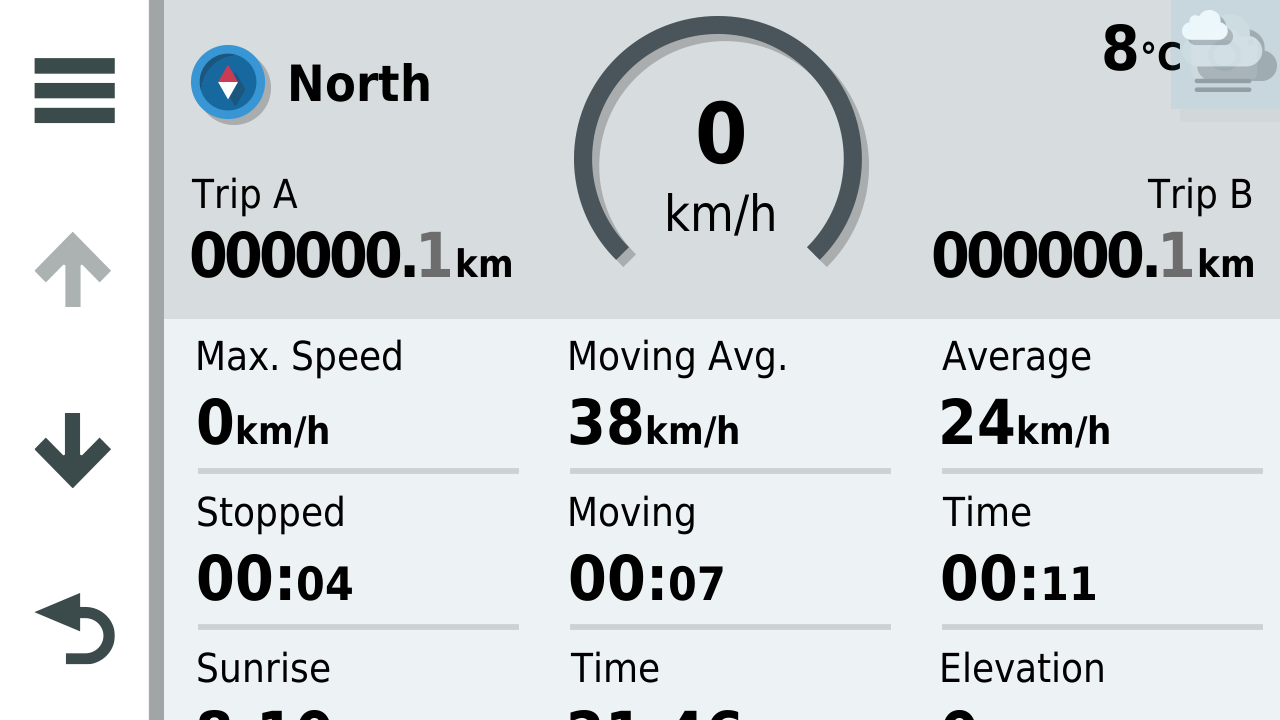

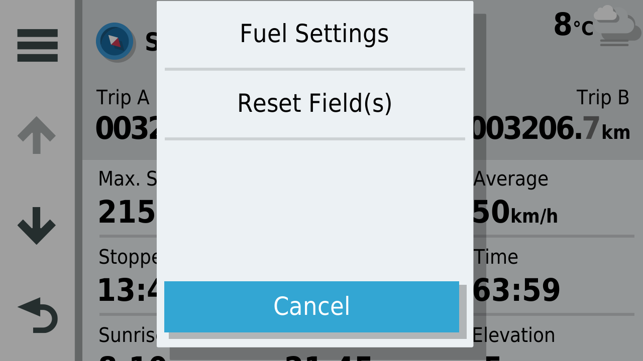

This was my max speed:
Click on the 3 bars, Reset fields
Check all.
And now it is. And yes even after power down/up

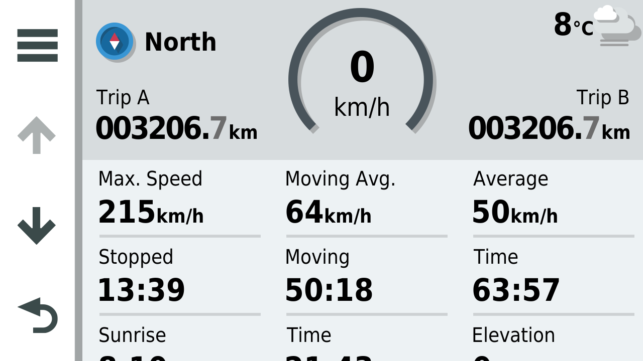

Btw: Cant imagine ever driven at 215 kmh :D

I took the XT for a walk and managed to get the max speed to 15 kmh, not bad for 60+ years.
I tried some combinations and it looks like 'Overall Data + Reset Max Speed' does what you want. Trip B is retained and the Max speed is reset to zero.
But please write down the Trip B data in case it should go wrong.
