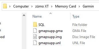

Thank you very much for the information. Unfortunately, my Memory Card does not include any gpx files. See attached.

Look for one in Internal Storage\GPX. The ones that can normally be found there are listed below. If you have another one, that is it.
Current.gpx
Temp.gpx
CurrentTrackLog.gpx
Re: Route for Import
Come to think of it, the Temp.gpx file holds the content of the route or routes last transferred from Basecamp. It gets overwritten with each transfer session but AFAIK, any routes that are in it remain available for import even after they have been imported.
