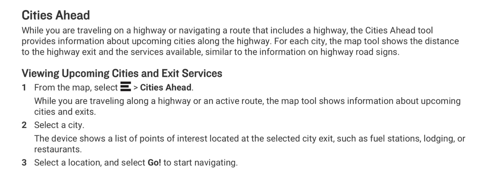

You could turn it off to see if that makes it go away. If it does, then turn it on again and see if you can configure it. Look at Cities Ahead - the XT doesn't have that but I found this in the XT2 manual.
