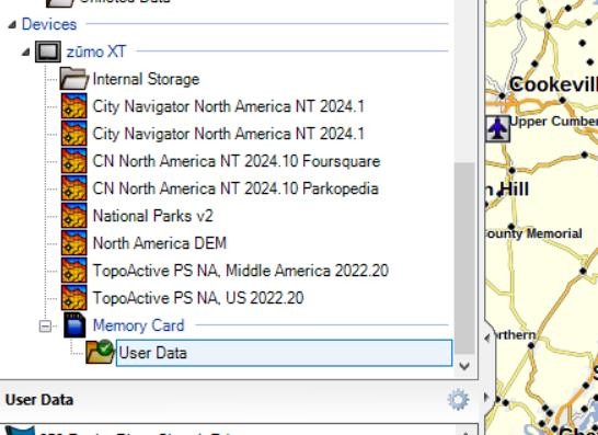

FWIW, when I want to send a route to my XT I right-click on it, select "Send To..." and then select the destination in the resulting popup window (the XT will show up as a device at the bottom of that list and offers either internal storage or User Data on the Memory card)

There is. With the XT connected you can delete data that is on the SD card from within BaseCamp in the same way that you would delete BaseCamp data. It is in Memory Card > User data.PaulaRay wrote: Tue Jun 20, 2023 8:37 pm Also, there must be another way to clean up an SD card other than jumping into Garmins hidden world of files.... At least I'm hoping so.
