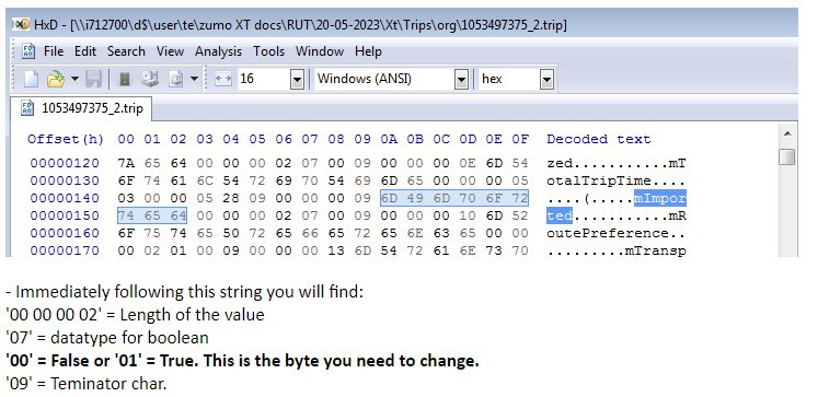

Hex editor
Suited for people who dont want to install software and are not afraid to dive into hexadecimal numbers.
Pros: Works on any platform via https://hexed.it
Cons: Can do only one file at a time.
Info: See screenshot which byte to modify
