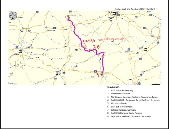

We have a 28 day trip planned in Europe. Some of my days have up to 9 Waypoints. There was no way for me to remember all these days and all the various waypoints for each of the days. So, what I did was print an 8 1/2 x 11 for each day and list the waypoints in a numerical list and then place a number on the map corresponding to the waypoint. It will give me a quick synopsis of the day and a general location of where the waypoint is, and what the waypoint is (in case I want to skip it on the fly). Some days have at least 9 waypoints.
Here, in the States during our local rides I don’t need to do this, but in Europe (where I don’t frequently go), I wanted a list to help me recall what my plan is.
Here is one of our days.

I have tried the method recommended by @Iris , but it gets complicated when waypoints are clustered in one small area.
