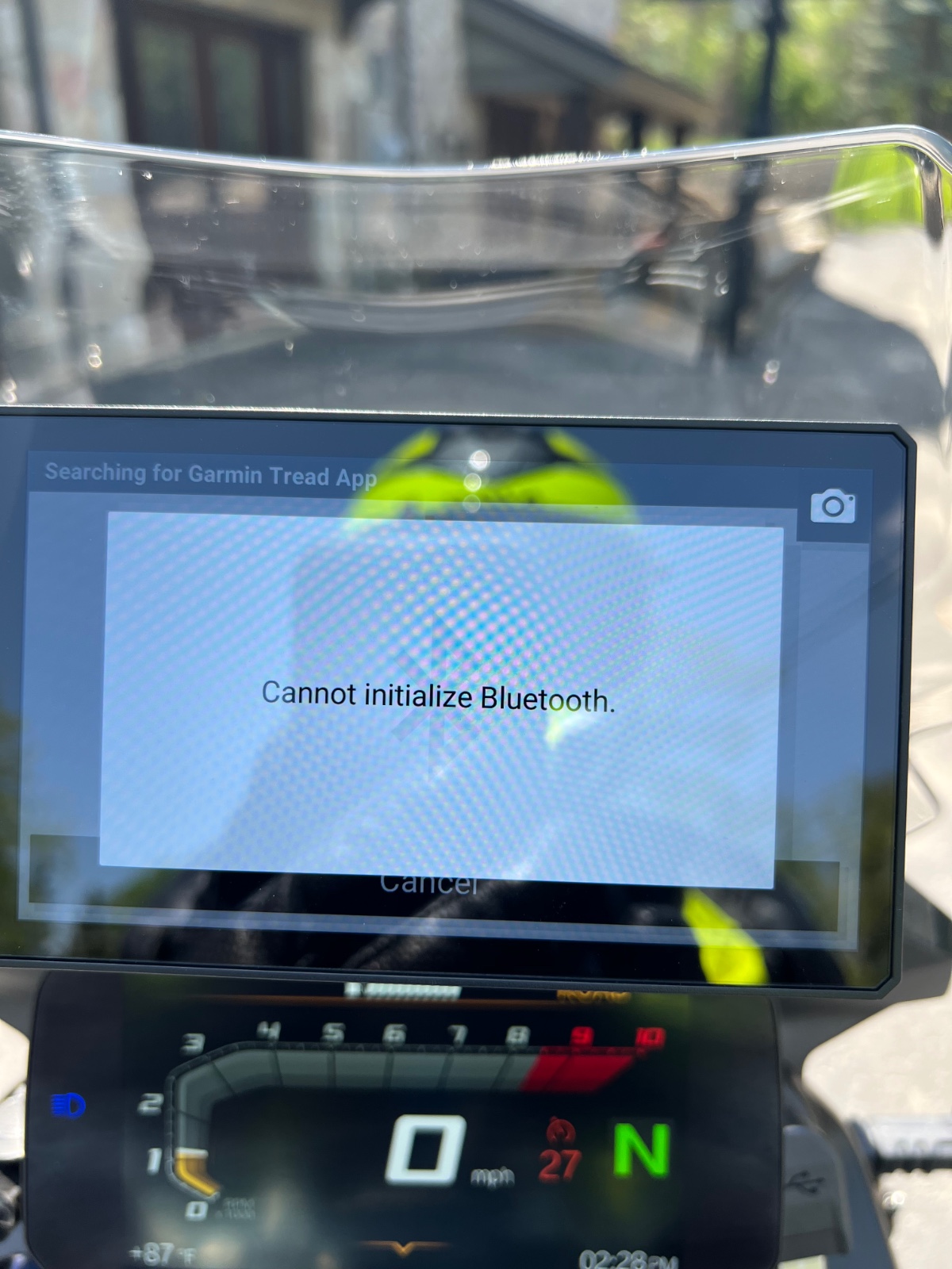

My issue is that the unit will randomly power off and drop BT connection. Communicating w/ Garmin customer support we thought it was initially a poor connector or poor power, but it will do same thing w/ fully charged battery and running on battery power. What is even more perplexing is that after a few times of unit powering down, the Zumo will display “Cannot Initialize Bluetooth”, see attached picture. Only a hard power down of the Zumo with the power button will allow the unit to reboot and re-connect.
