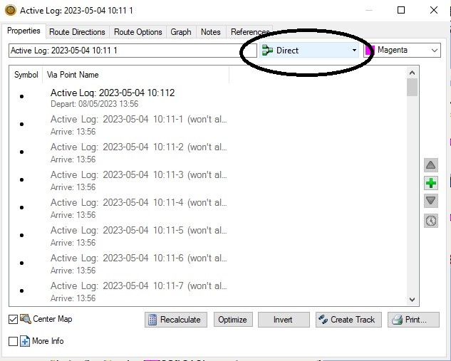

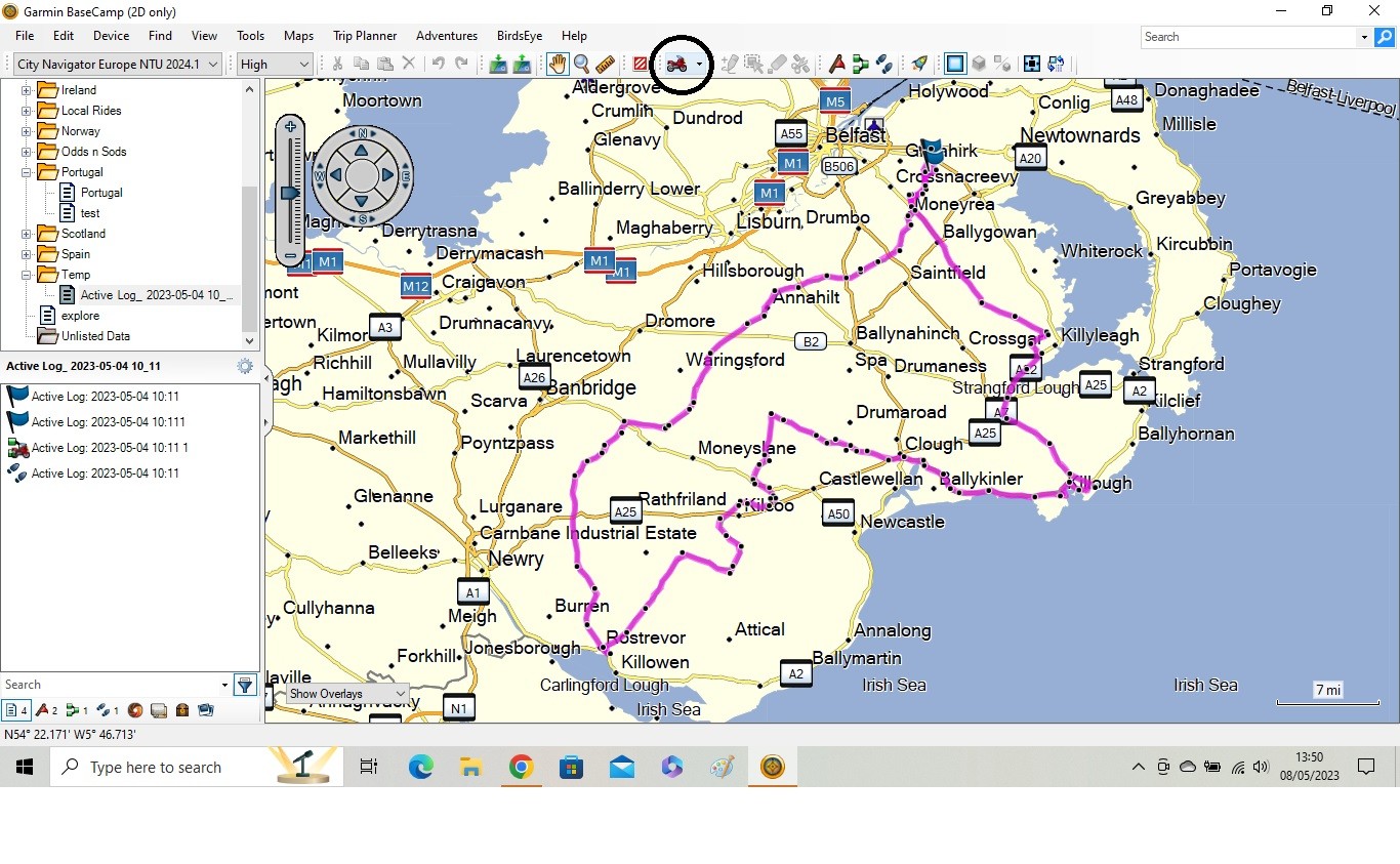

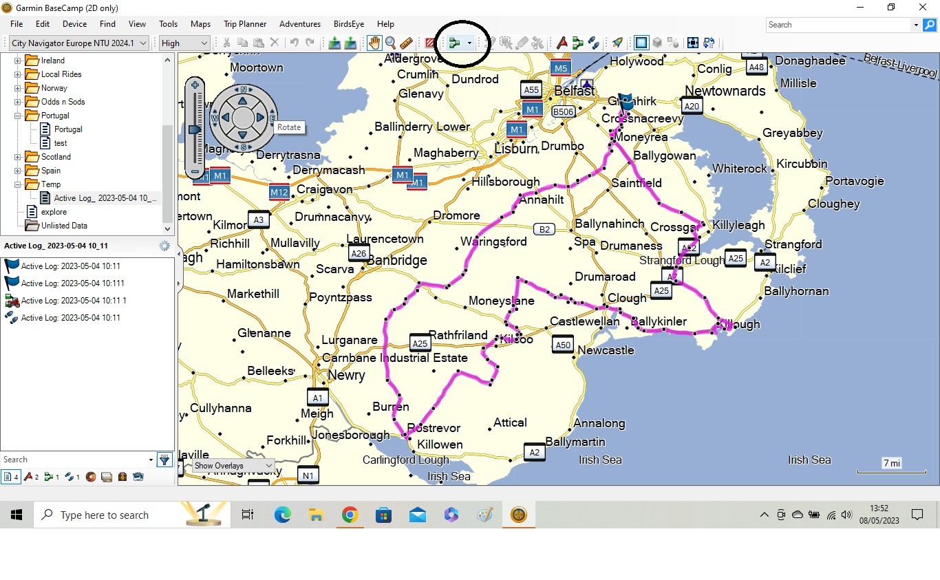

Hopefully these screenshots will explain a little better of a track I converted to a route. Open the track and change profile at the top of the page to direct.

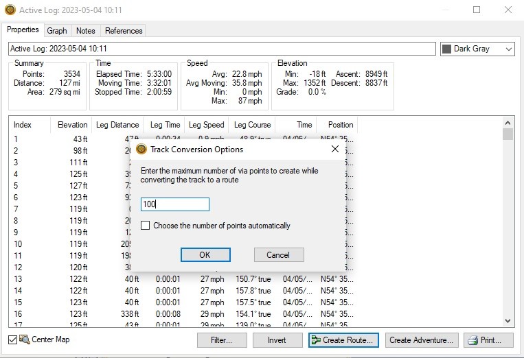

Click create route in the dialog box and select how many points you want.
Create the direct route this will not have turn by turn directions.

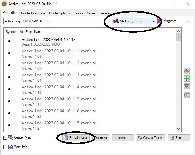

In the route dialog box change the profile to motorcycling and recalculate

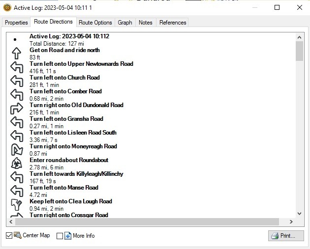

this will give you turn by turn directions and the ability to edit the route. With in this case 100 shaping points.

Aaah, now I see.
The initial track must be changed from Motorcycling to Direct, outside of the dialog boxes (on top Basecamp as per your first screenshot).
It works perfectly - thanks!

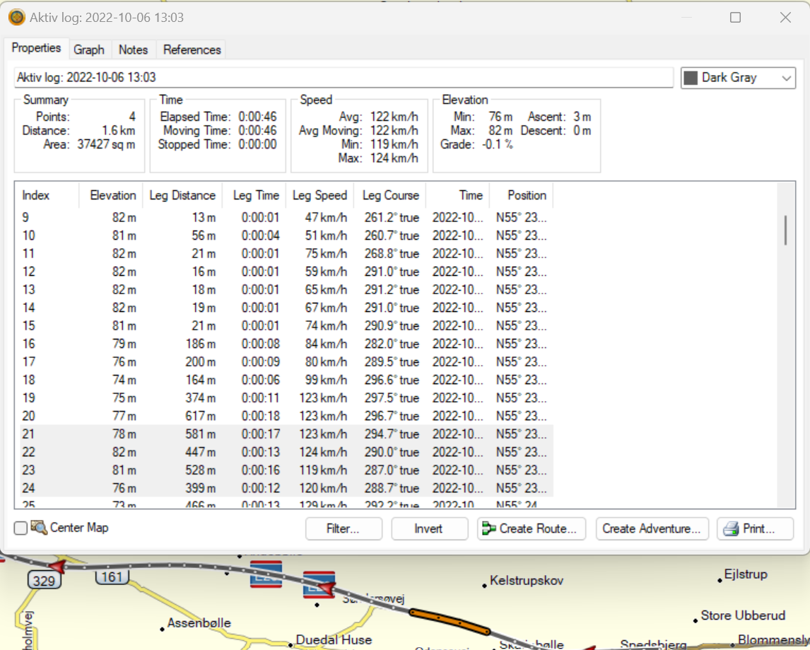

If it's worth anything to anyone, I can add that I've realized there's another way to shrink a track, using the GUI.
Open the track by double clicking it. It opens in a popup window. Move the window so you can see the track on the map behind it.
In the track window: Press and hold Shift to mark several contiguous points. On the map behind, the parts of the track marked, turns orange.
Press Delete to remove the marked (ghost)points.
Repeat as necessarry, leaving only few points.
The track is now shrinked - and a few KB's have been saved
