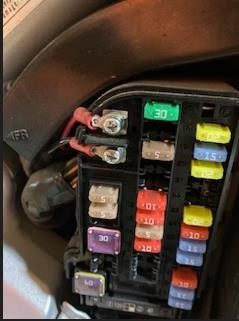

Welcome to the forum. I have a 2008 GL1800. There is an accessory terminal in the fuse box (two screws, upper left). Connect to that if you aren't already using it. That terminal is switched so is powered only when the ignition is On or Acc. No fear about leaving the GPS connected and drawing down the battery. Works great for my XT. Snaking the wire under the plastic was the only challenging part of the installation.

Just in case a picture is worth a thousand words...
