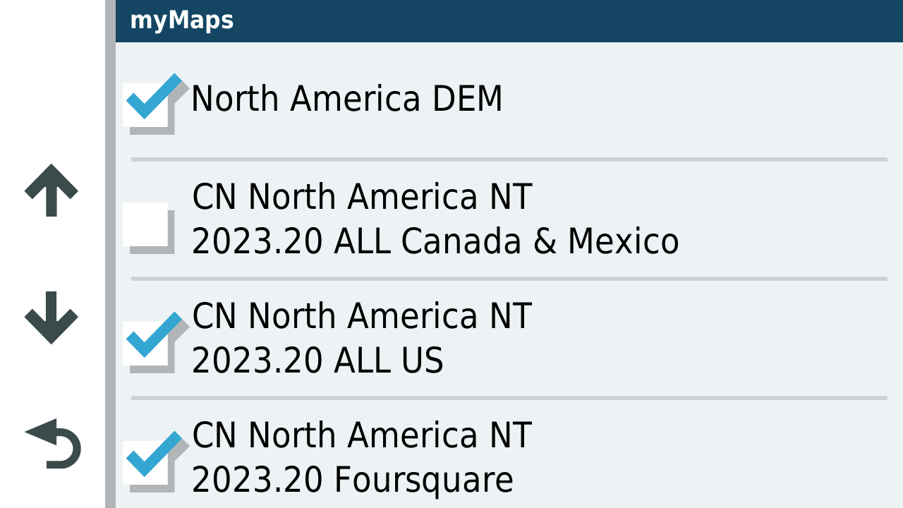

Re: CN NA 2024.10
On the XT there is a way to turn off Canada and Mexico. It is in Settings > Map & Vehicle > myMaps. Wonder if that exists on the 660.

Posts: 2124
Been liked: 560 times
Re: CN NA 2024.10
That is a shame. When you get your XT it will list Canada & Mexico as a separate map from All US, like this:
