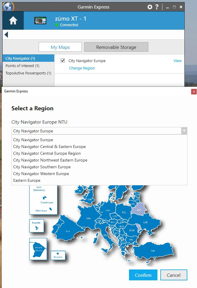

Hmm... Does this control the regions of the map that get transferred to the PC?

Verify that you have the CN UK map turned on, as I think the EU map is split into sections to keep each portion under the 4Gb FAT32 file size limit.
See Settings>Map & Vehicle>myMaps to be sure the appropriate maps are checked.
If that is OK, in Express, you might try Map Details>Map Options>Reinstall Map. (oops, you already did that)
A more drastic option would be to delete everything in the hidden folder .System/Map and then run Express.
If you think the 390 is running short on internal storage, I've found that on my 590 the contents of .System/SID can also be safely deleted. These are installation files that Express will re-create as needed. Express does not always delete the old files during an update.

Please verify what you see in Settings, Map&Vehicles, myMaps? Without knowing what is actually installed we're shooting in the dark955Tiger wrote: Thu Jan 05, 2023 9:26 pm I have just updated my Zumo to City Navigator Europe NTU 2023.2 and run into a problem.
