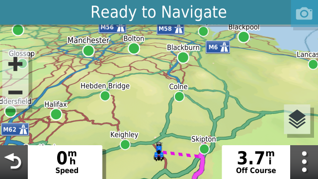

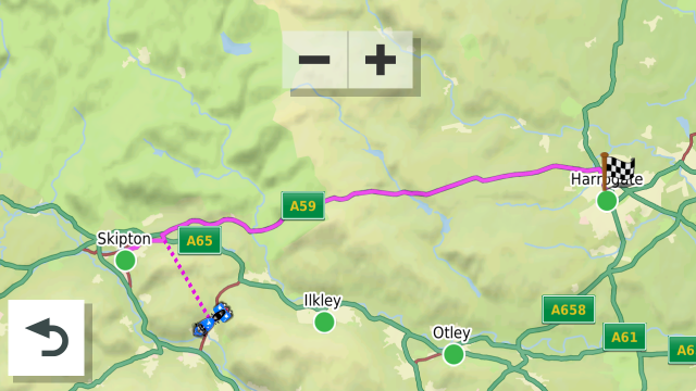

Here is an example taken from the XT - loading a track and using the track to navigate.
But the dotted line doesn't navigate me to the start of the route. In fact it doesn't navigate me at all. It simply sits there pointing the direction to the closest point of the route from my current position, which is some way from the start of the route. The fact there are no roads going over the top of Ilkley Moor is irrelevant. It points the direction and in the bottom right hand corner, it shows me how far I am 'off course'.
I don't know whether or not this is what you are doing - but it may be. I can't even find out if the 396 allows you to select Go! after choosing a track. It's not mentioned in the manual, but it isn't mentioned in the XT manual either !
So if you can describe precisely what you are doing in order to load and start your Lews to Bear at Burwash track, in a similar way to what I have written above (in bold blue) that would be a massive help.
Main Screen -> Apps -> Tracks -> Select Track-Lewes to Bear -> Map is displayed -> Go!
or
Main Screen -> Track -> 2 pin track icon, top left -> Select (the track name) -> Map is displayed -> Go!
After that I have the option of choosing "Start to Finish" or "Finish to Start"
Select Start, and I get a dotted straight line pointing to the track and a solid magenta line after showing the route itself.
